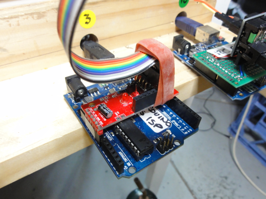

    Tip 4 years ago
    One hand operation with strong elastic band holding contacts on Arduino.
