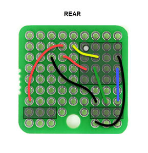

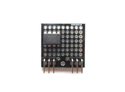

Step 3: Assemble the Circuit
  1. On the front, insert the components ATTINY85 (1), 3P 90deg male headers (2)(3), and solder off on the rear.
  2. On the rear, trace a yellow wire from YELLOW1 to YELLOW2 and solder.
  3. On the rear, trace a blue wire from BLUE1 to BLUE2 and solder.
  4. On the rear, trace a green wire from GREEN1 to GREEN2 and solder.
  5. On the rear, trace a black wire from BLACK1 to BLACK2 and solder.
  6. On the rear, trace a black wire from BLACK3 to BLACK4 and solder.
  7. On the rear, trace a red wire from RED1 to RED2 and solder.
  8. On the rear, trace a red wire from RED3 to RED4 and solder.
The relay can now be connected directly via its pins to the PCB or via wires, to the points shown in the pin contract.
