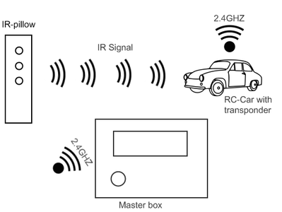

Function description:
You need at least 3 devices:
IR-generator pillar: This device contains an Arduino mini generating a very short IR code. Via 3 IR-LED's the code is beamed permanently.
Transponder box within car: Arduino Nano/mini + IR receiver + NRF24L01 module. If a IR signal code is recognised (car is passing the IR pillar) a short unique code will be send via the NRF2401 module to the master box. Up to 6 different transponder can be used (Currently only 2 are implemented)
Master Box: Arduino Nano + NRF24L01 module + Encoder + Display. Collecting the transponder data for generating lap times,…

The IR receiver is connected with a longer cable and should be fixed on the highest place of you car (rear wing). Important: The IR should be on the RIGHT side so collecting the data from right. So the IR pillar is on the inside of the track and beams to the outside otherwise you may cross the track with the signal.
