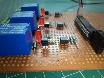

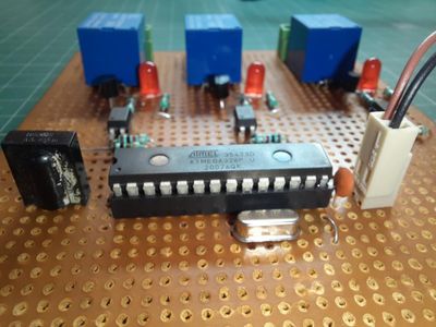

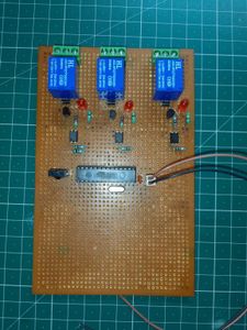

Step 7: Circuit Making
We will make this circuit in sections, so that circuit can be more understandable to us. First mount all the relays and screw terminals corresponding to it as shown in the PCB.
Taking idea from circuit diagram and PCB, mount all other components transistor, optocoupler, resistors, diodes and led. Using the same idea, we can increase relay channels from one to three and even more. Maximum relay channels that can be supported using this method is 12.
After controlling circuit, we will build microcontroller and power supply section, here we are using Atmega328p- 8bit Arduino’s popular microcontroller. This is more than enough for this type of project, Atmega328p works on 16Mhz crystal and also have EEPROM feature. EEPROM is helpful to keep last state of relays in mind when power goes off or disconnected.
In last we will connect TSOP-1738 and read Hex data values using Arduino digital input pin. Code is exactly turn ON/OFF the corresponding relay as stated in code.
A 9volt battery is enough to power the circuit properly. Our microcontroller and relays work on 5volts, that’s why using 9volt battery, a 5volt regulator (7805) is mandatory to use.
While working with general purpose PCB board, we should use pointed tip soldering iron, 63/37 solder wire and try to build this circuit using bridge soldering method.
