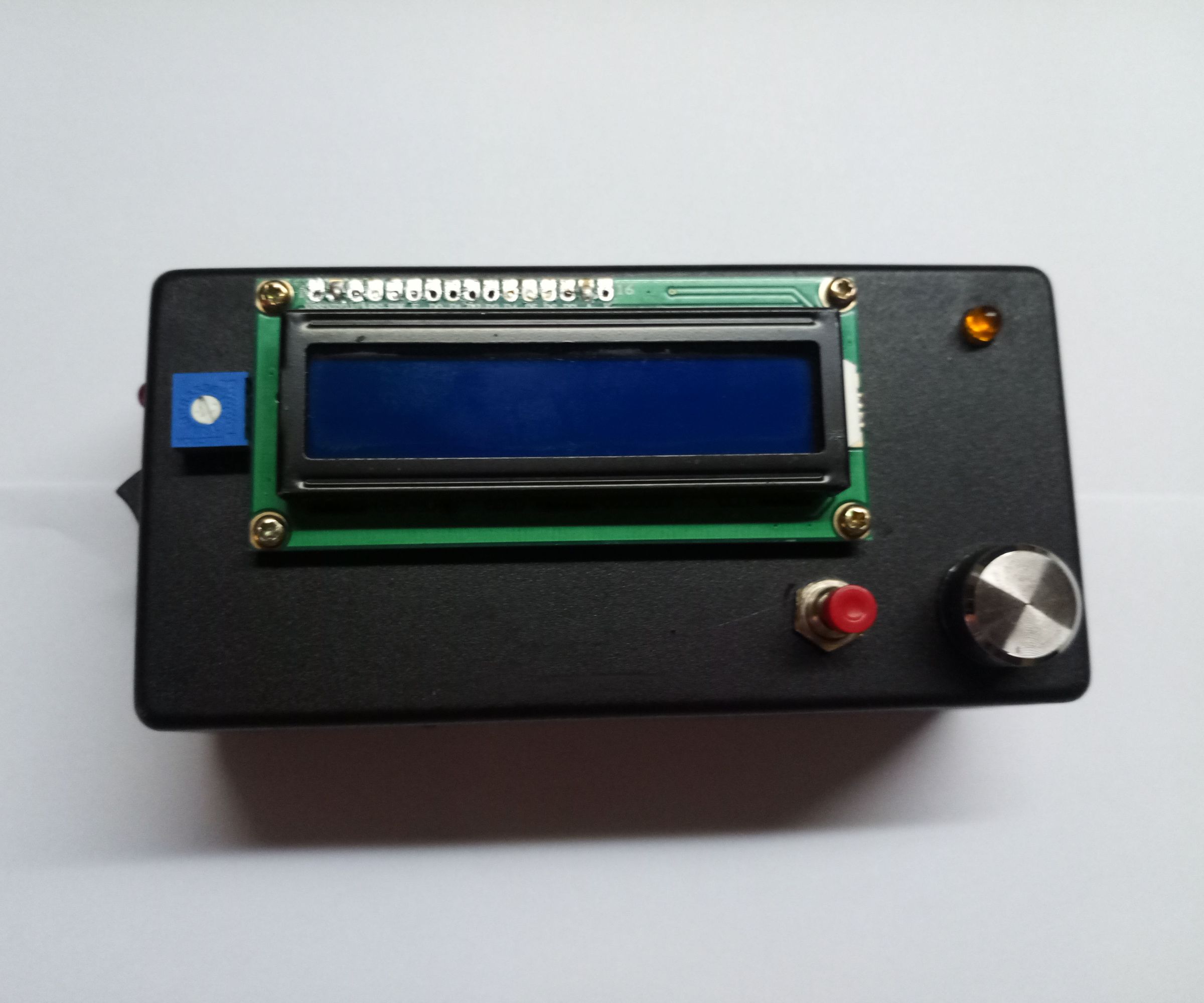

Infrared Control, Using a Texas Instruments MSP430G2553 programmed with Energia IDE (Arduino IDE clone). In the photos I have to mount it in a cabinet, even though it is already with another source and in a plastic cabinet, I promise to update the photos when possible, since it is installed and in use, so I would have to take it for the photos. This project was created using a lot of recycling material and was modified on the fly, I don't have a complete list of materials and I don't have a diagram of the electronic circuit of it, I hope to be able to update this publication with more data.

Step 2: System Mode
Operating Modes
- Normal Mode: this is the default mode that allows to control the relays by means of an already programmed control.
- Reading Mode: This is activated by changing the switch before power on the system, this allows the reading of the codes of each button that are pressed in a control, it requires to be connected to a computer to be able to read the data by serial console, this way after capturing the codes the IRCodes. h file is edited and the board is reprogrammed with the updated codes.

We are going to schedule, just download the compressed file and extract it, this creates a folder "IRControl" with two files "IRControl. ino" and "IRCodes. h" inside it, you have to move this folder (with the files) to the location where they save the Energia IDE projects. then start Energia IDE, configure board, port and open the IRControl project, just program the MSP with LaunchPad and you will be able to use the IRControl system.
