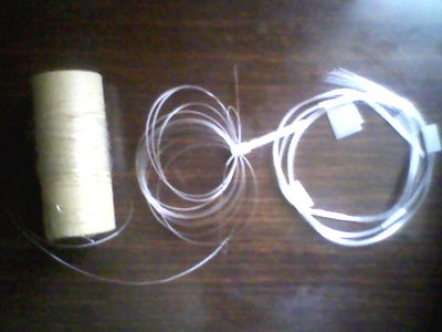

glue (will use mostly no universal model glue or special glue because it dissolved the optical fiber which is also called fiber pvc)
optical fiber Ø 0.2mm
optical fiber Ø 0.5mm
optical fiber Ø 0.75mm
drill Ø 0.6mm and Ø 0.8mm

each pieces, make a bundle of fibers with the duke tape. and repeat the operation as many times as necessary.

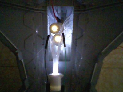

after, cut the extremity of the fiber bundle to put them on the same level. enter by following the package, or with another if possible, in a hose. on the other side of the hose, place a white LED.
Step 3: Electronic
at that time, I made the mistake of using adjustable resistances, over time, it ended up grilling by LED short circuit. I recommend using resitances 230 ohms. I also added a battery charging system 9v placed underneath, and a interuptor placed between the two towers.
5mm blue LED should have their soldered cables, before being glues to the engine. continue to solder all the LEDs.
doard for bread, I recuperated. and thus reused for my editing.
it is quite difficult to tidy everything bunch of cables, fiber and another for all find it instead. I got into it several times.
