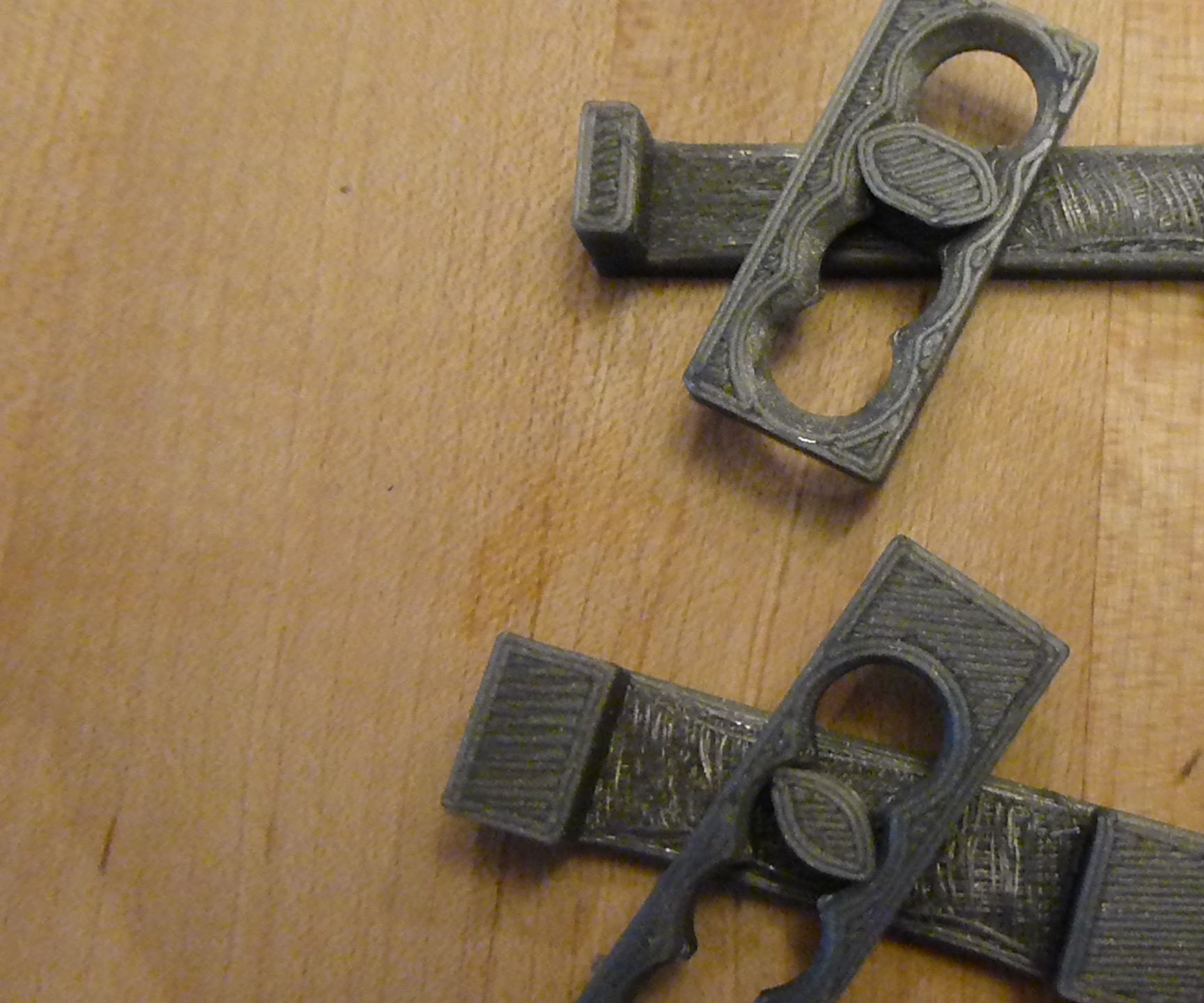

Introduction: Improving 3D Prints With Hairspray
One of the easiest ways for a print to fail is if the material separates from the bed. There are expensive sticky sprays you can buy, but cheap hairspray can be easily used to improve adhesion.

Touch the bed. It should feel sticky to the touch. If not, repeat the process. Try sticking up areas of the bed individually. The bed will now stick to prints much better and prints will have a much smaller chance of peeling off, and you probably won't need to print with a raft. You will probably need to reapply every 2-8 prints.
