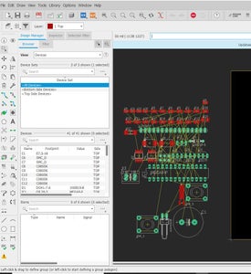

For circuit design, I use Autodesk Eagle for design schematic and pcb. Eagle is easy and flexible schematic and pcb designer. I had been using if for very long time. It very suitable for D.I.Y and Hobbyist. This program will allow you draw schematic, place component that need and generate component to pcb board editor. So. There are 2 main editor windows of Eagle , Schematic editor and pcb Board editor. I like this program as you can change or edit or create libraly to suit your project. On Eagle board editor you can arrange component the way you need and manual rout pcb trace as you like. As for me I didn't do very complex pcb or multilayer pcb or any big pcb so it free version /education version of it is more than enough.
Now for this project circuit designed. They have serveral part that we need to create
  1. Main Micro Controller , In this case I use ATmega328. It's pins identical to Mega8 so I use Mega8 in this design as it already have this in eagle libraly.
  2. Regulator Part use LDO MCP1702-5V simple with tantalum capacitor.
  3. LCD 16*2 use 16 pins single row Pin Header.
  4. Hbridge using mosfet BS170 and smd FDS8958 Dual N and P channel in one package.
The important part that control latching valve is the H-Bridge Circuit. This circuit consist of 6 mosfet 3 each side this will allow micro controller control output of voltage eather low (0V) or high (V+) using 2 digital pin each side. This circuit can be replace with Hbridge Motor Driver ic. But for me I would like to learn basic electronics so I decide to use simple mosfet Hbridge circuit. I'm not a professional in electronics so my circuit just designed by my learning and experiment, This is not precise calculate circuit. I just looking for mosfet that available in my place and find datasheet. As long as electrical characteristic suit my need ,current,voltage. But so far this circuit do the job very well and stable.

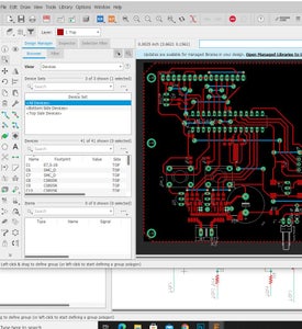

After designed and put every component to Eagle schematic editor. Link all signal pin between components.We switch to the Eagle board editor. Every component from schematic will now show in board editor. Ready for boaed designed.
Step 3: PCB Layout Designed

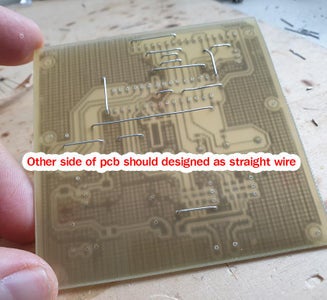

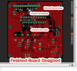

After schematic designed. Next we will create a PCB Layout using Eagle Board editor. After switch circuit to board in the first time Eagle will create board file with all component from the schematic.Then we can arrange place of components as we like. After that I will rout each component with signal line. Now, For one side PCB. If you want pcb copper routing top layer like mine then the bottom layer will need to designed connect as straight jumper wire. It will be easier to connect. If you want copper on bottom then top layer should be straight jumper wire.
For using my method to make D.I.Y pcb. The copper signal line connection should be use a thicker line atleast 0.016inch, I use 0.024inch width for copper signal line. For via diameter better at 0.08inch. And for groundplan I used hatched style plane as it will make easier for DIY PCB and soldering. Now!! It's ready for D.I.Y. Pcb Process.
