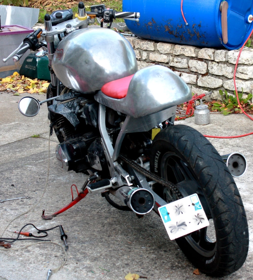

The examples in photographiessont for gold, and aluminum on the motorcycle.
This gives an idea of the effect.
