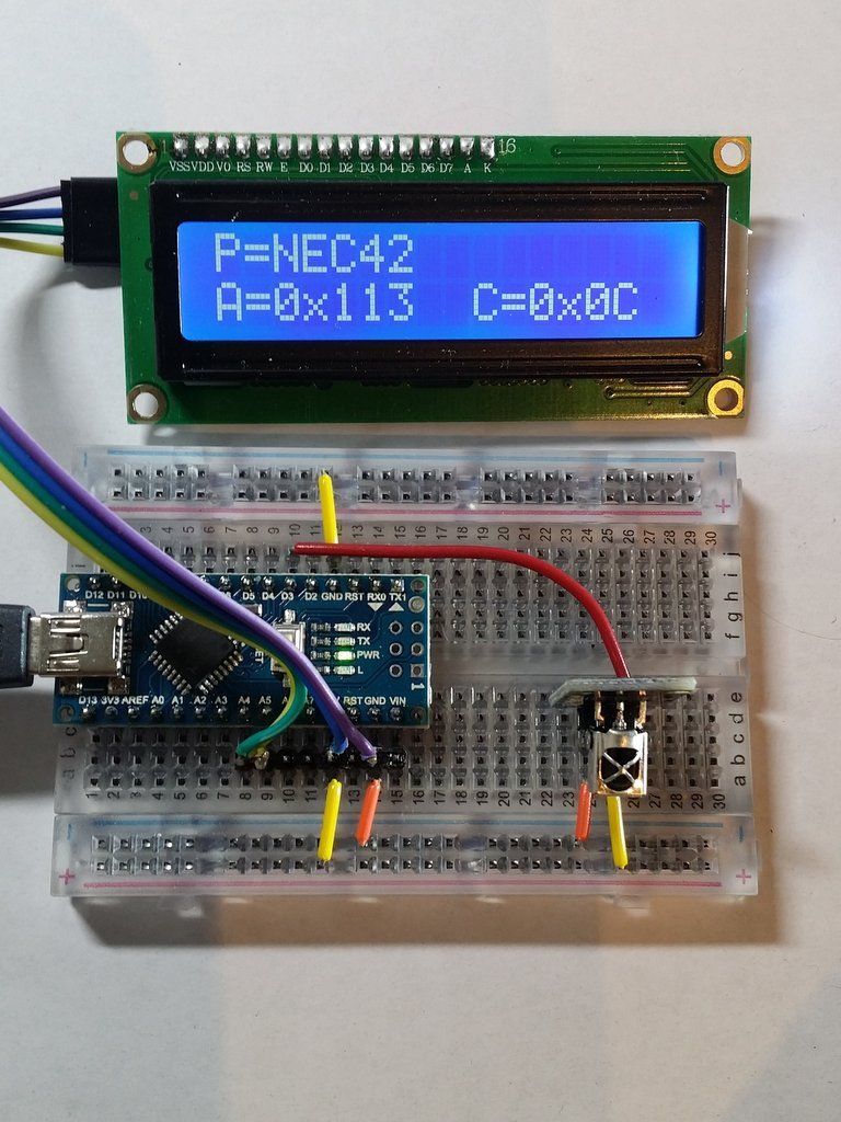

Consider to use the Arduino IRMP library for receiving and sending.
