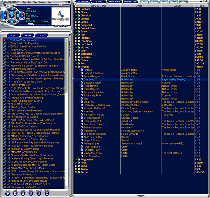

I want to control my music player on the computer. I use MusicMatch. The program is quite old already but much better than WinAmp or Windows Media Player. The most important functionality of the program can be controled via keyboard: Play, Pause, Stop, Next Track, Previous Track. This is all I need.

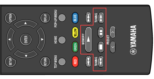

My amplifier has this remote control:
The buttons that I marked in red have no function when listening to music from the computer.
They are for the tuner and for other purposes.
When I press one of these buttons the amplifier does not do anything.
So my idea was to reuse these buttons to control the computer.

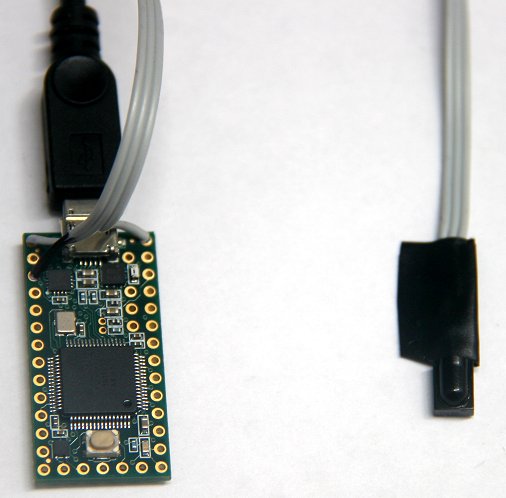

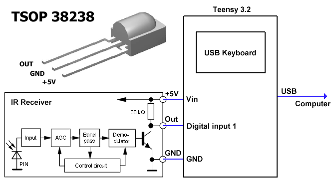

The Hardware

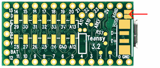

Only two parts are required: An infrared receiver chip and a Teensy 3.2.
The +5V power for the IR receiver comes from the USB cable.
The 3 wires are easy to solder even for a beginner.
The IR receiver TSOP38238 is very sensitive. It has a 38 kHz bandpass to filter the signal from the remote control.
This filter is required to eliminate noise because fluorescent lamps emit a very "dirty" light.
If you use a fluorescent lamp in your living room you may get a worse sensitivity for the remote control.
The majority of remote controls uses a 38 kHz carrier frequency. Some use 36 kHz which will also work. (See datasheet in the Zip file)
Only few companies (like Bang & Olufsen) use a completely different frequency.
In this case you need either another receiver chip or another remote control.
You can buy this IR receiver (or a similar model) in several online shops:
Also the Teensy (US $20) can be bought from Adafruit and from Digikey. Or you buy it directly from PJRC.
The Teensy 3.2 is a very versatile and very fast board with a lot of memory.
In contrary to the Arduino boards the Teensy comes with a better software library (TeensyDuino) that easily allows to simulate USB devices (keyboard, mouse, joystick and more). Additionally the Teensy is much smaller (3,6 cm x 1,8 cm) and cheaper (US $20) than Arduino boards.

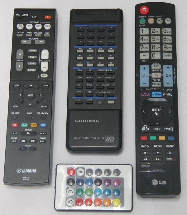

Remote Controls
Here you see some remote controls that I used for testing:
They are from a Yamaha amplifier, a Grundig amplifier (from the 1990's which still works!) and from a LG TV. In the middle below is a remote control from a RGB LED strip that allows to chose the color. Any of them can control the computer without the need to adapt my source code although they send completely different signals.

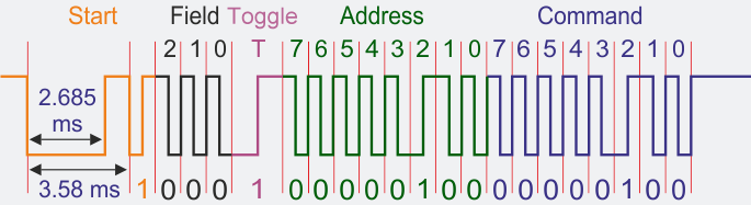

There are remote controls that send a toggle bit. A typical example is the RC5 code which has been developed by Philips:
This means that each time you press the same button on the remote control this bit is toggled. So you get two CRC codes for one button: One with the toggle bit = high and one with the toggle bit = low. In this case your code must look like this:

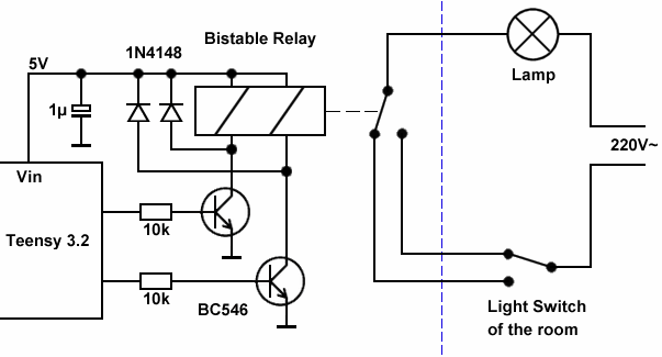

A simple light switch
You can extend the main light switch of your room with a bistable relay. So you can switch the light on and off either via remote control or via light switch.
A bistable relay has two coils and needs only a short pulse to switch into the other position and stays forever in this position until the other coil gets powered. You find bistable relays for example at Digikey. The PB1695-ND needs 80mA at 5V. It costs US $4,40 and switches 16A. The pin Vin of the Teensy is connected directly to the +5V of the USB cable which delivers enough current (500mA) for the relay so you don't need an extra 5V supply if the computer is running.
But if you want to switch the light also if the computer is off then you need an additional 5V supply and you must cut the jumper at the bottom side of the Teensy to disconnect this 5V supply from the 5V of the USB cable.
