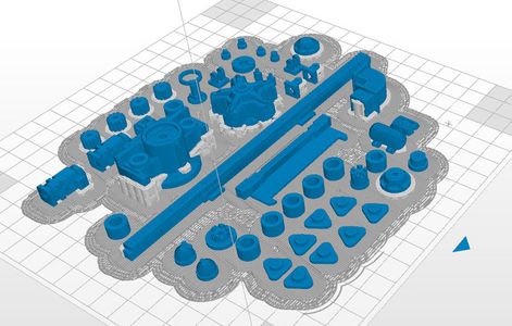

Step 3: 3d Printing
Completed the modeling, the pieces have been grouped in the various colors of the final print,
it was not expected to color the model.
More than 25 groups, over 215 hours with Z axis precision 3D printing 90 micron, Slow speed setting.
It was important to manage the arrangement of parts on the printing table,
so to get the prints with a high quality in order to avoid important work of post production
Materials used Z-ultrat, Z-abs is z-glass (for the base), for a total weight of about 1.1 kg.
