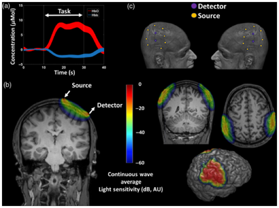

Project OpenHEG uses a niche light-based technique for brain imaging, called “fNIRS”, (pronounced Eff-Neers). This technology is extremely old and is based on the same technology as pulse oximetry. (You know, that little thing they clip to your finger at the doctors office that reads your heart beat).
fNIRS, meaning “Functional Near-Infrared Spectroscopy”, uses near-infrared light to penetrate your tissue and measure the presence of blood. Now you may be wondering how this could possibly pass through your skull to measure the brain, but that’s the fantastic thing about infrared light: bone is invisible in the infrared spectrum, meaning the light passes right through it like glass!
The light goes into your noggin, bounces around and gets absorbed by the blood in the brain, and comes back out where we can measure it.
As this adsorption and diffraction happens, it causes the light level to go down. The amount It goes down is directly correlated to the level of oxygen in the blood. This is called oximetry.
Now there is an important phenomenon that occurs in our brains which allows this to happen, and it’s called Neurovascular coupling (NVC, I know more silly acronyms). This phenomenon says that there is a direct correlation between relative blood flow in the brain and brain activity!
When a neuron fires, it needs oxygen, and the only way for our bodies to give it the oxygen it needs is by sending over some blood.
This means that brain activity creates an increase of oxygenated blood in the brain. If we measure the presence of oxygenated blood, we are actually measuring the relative level of brain activity in that region!
