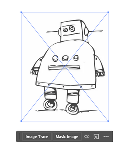

I opened Adobe illustrator, and uploaded a line drawing of the Instructables robot. I clicked "image trace" to automatically trace the image that I had selected. Image tracing turns pastor images, such as the one I had selected, into vector based images that the laser cutter can cut.
