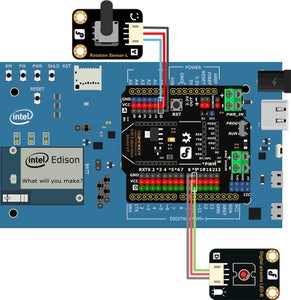

Step 1: Connection
Analog Rotation Sensor → Analog Pin 0
Digital piranha LED light module → Digital Pin 9
