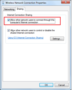

Step 4:
Go to the 'Sharing' tab and check the option 'Allow other network users to connect through this computer's internet connection'

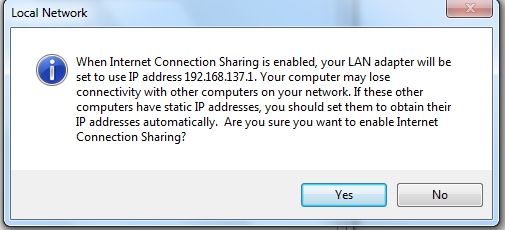

Step 5:
In the prompt, click 'Yes'
