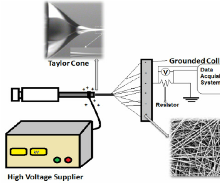

The concept for which the intel edison is used to develop the electrospinning system with Intel IoT.
Step 1: Parts Included in the Design
The components which are required for this process. Relay: to control the power, Intel edison devkit to control all the peripherals, LCD to display the current value, Servo motor to move syringe, dc motor to rotate the drum, Temperature sensor to sense the surrounding temperature.

The required components are connected and interface to the edison board and the gear motor is controlled with relay and button, LCD display is used to visualize the temperature values and the color of the LCD is change according to the temperature range.
Step 6: OverAll Setup
The edison board is connected to program the functioning of electrospinning system the all necessary components are attached to the board.
