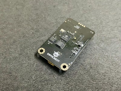

I will say this DF2301is a smart sensor, not because it has some AI or Internet models working inside. Because this sensor is capable of giving you the essence of new generation Machine learning models. Running on a small microcontroller it is able to convert the speech signals into text by recognizing them. This module can be trained to do different tasks, as the tutorial will proceed I will tell how to train the module. I think this is the best piece of electronics and computer engineering, having a lot of features. This offline speech recognition sensor is built around an offline voice recognition chip, which can be directly used without an internet connection. It comes with 121 built-in fixed command words and supports the addition of 17 custom command words.
This small sensor can be interfaced with any microcontroller board and then different actions can be performed over voice. It will be the same as Alexa but with much more restricted commands and answers. Because overall it is a small ML model working on a little microcontroller. Some popular applications are such as various smart home appliances, toys, lighting fixtures, and robotics projects, among others.

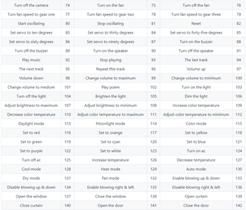

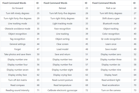

2)Command words: Fixed command words refers to the designated vocabulary used by users to issue specific instructions. Here these words are essential because, after all, this is an offline module and does not have external data/server from the internet to process. So these are the already processed, trained words which are stored in the memory of the module and whenever triggered produce the corresponding ID, which can be used to specify the different actions later on. There are a total of 121 words which are already defined for specific functions over different ID’s.
Now whenever working on a project it is not always good luck that these commands work for you. Means sometimes we need some other commands. Which is possible to do here, known as a custom command word. And there are a total of 17 Custom command words you can train the model on.

After the completion of the learning process, an ID will be automatically generated. Please see the table given above for the wake up/ Custom and Fixed command words. Before each session of learning command phrases, it is necessary to delete the previously learned command phrases.

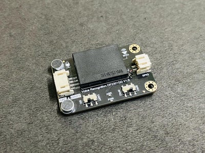

While turning on for the first time, Some hardware settings could be done. The module has an integrated interface of I2C and UART. Usually I2C is used because of having good speed. So choose the I2C by sliding the switch to that position. This board has the option to use an onboard or external speaker, which can be configured by the user. A small onboard amplifier is then used to power the external speaker. The blue light on the module indicates the active mode and the red light indicates standby mode. Whenever the wake word is spoken the module pushes itself in active mode from standby mode and then we can perform further actions.
