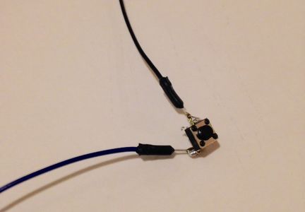

Before you start laying out the circuit. You should solder the LED and the pushbutton to long jumper wires (see above photos.) These wires will allow the components to extend to different parts of the creature's body. After this is done, grab the breadboard and plug everything thing in according to the diagram shown above. I recognize that in the picture the board is an Arduino, but all the pins are the same so you can just ignore it -- when it says to plug something into D4 on the Arduino, you should plug it into D4 on the spark core. Lastly, adhere whatever you want to move from the stuffy to the servo horn. I cut off its arm and hot glued it on. Now it's time to move onto the software aspect of this project!

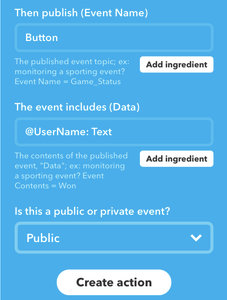

Step 3: Set Up the IFTTT Event
IFTTT is wonderful, free, and easy site for basic home automation. Let's create a simple applet for the Spark Core. Read these instructions and check out the pictures above to follow along.
1. Sign into your account, and go to your applets.
2. Create a new applet.
3. Click on this.
4. Search for and select Gmail as the service.
5. Select New email in inbox from as the trigger.
6. Enter the email address you want to be notified of.
7. Click on that.
8. Search for and select Particle as the service.
9. Select Publish an event as the action.
10. Fill in the form like the following:
Event Name: Button
The event includes (data): @UserName: Text
Is this a public or private event? Public
11. Select Finish and publish the applet!
