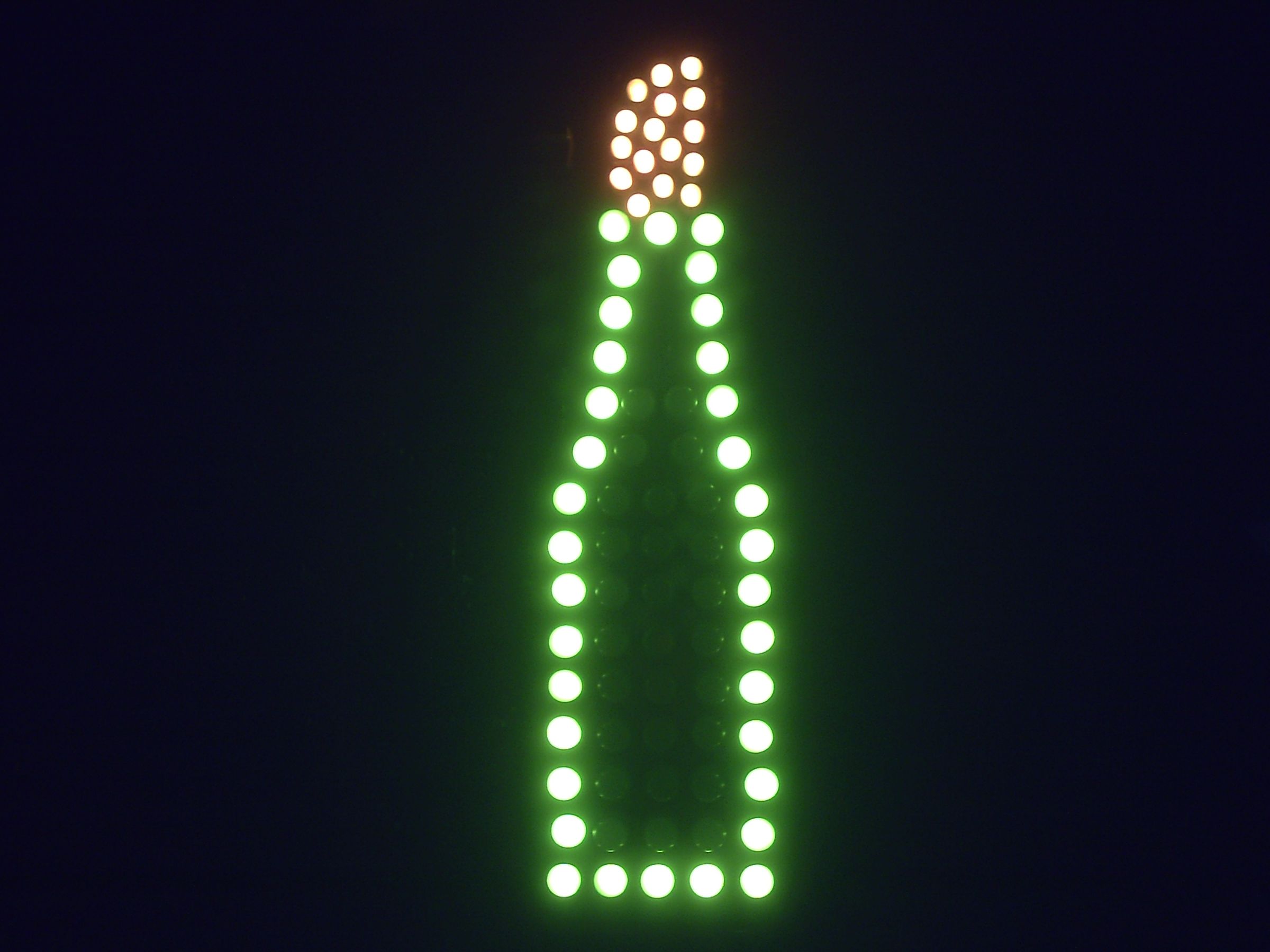

The table contains 384 individually controlled LEDs with half of a ping pong ball over top of each LED, 20 RGB Pods that are able to detect whether a cup is over top of the pod and 2 ball washers that will pump a ping pong ball from one side of the table to the other with water, clean it, then blow it back up so that the player can grab it. On each side of the playing surface, we have a 6 inch wooden rail with 4 LED rings per rail and two LED rings for each ball washer.
I have attached a PDF of my AutoCAD drawing seeing as the jpg file isn't very clear. You will want to print this sheet out and use it for reference when we are modifying the table. I have also attached the AutoCAD 2012 file if you need to modify the table to suit your needs. You may notice that the creation date on that file is August 16, 2011. I actually designed this table and demoed the RGB pods, ball washers and LED grid quite a few years ago. I had just never got around to building the table and integrating all of the features together up until one year ago.
32x12 LED Grid
In the center of the table we can create any animation that will fit into a 32x12 pixel grid. We are able to display scrolling text across it, watch a pong animation, display a sine wave, display the score of the game, etc. There is a huge amount of possibilities! Since we are able to detect when a cup is removed from the table we can make specific animations that trigger exactly when that happens. We'll get more in-depth with that later.

Step 45: Software: How the LED Grid Data Is Packed
Looking at the grid in the first photo, you will see that ROW0 is represented by LED_data[0], ROW1 is represented as LED_data[1], ROW2 is represented as LED_data[2], all the way up to ROW31 that is represented as LED_data[31]. Since each LED_data[x] WORD is 16-bits, we can represent the 12 columns with 12 of those 16-bits (the 4 MSb's aren't used). For each LED_data[x] WORD, COL0 is represented by bit 0, COL1 is represented as bit 1, all the way to COL11 which is represented as bit 11.
The ROWs of the grid are represented as the x-plane and the COLs of the grid are the y-plane. If we wanted to turn on the pixel at location (0,0) we would set LED_data[0] = 0b000000000001 (0x001). When the grid updates it will see that bit 0 of LED_data[0] is equal to 1 (ON) and send the required data to the HT1632C to turn on the pixel.
Let's do the example in photo #2.
We only want to turn on the pixel at ROW11 and COL7. We would navigate to LED_data[11] and set bit 7 equal to 1 and then update the grid. It's as easy as that.
LED_data[11] = 0b000010000000 = 0x080
Here are the values for the example in photo #3 (I have only listed values for the ROWs that have one or more pixels that are on).
LED_data[3] = 0x004
LED_data[7] = 0x080
LED_data[11] = 0x210
LED_data[16] = 0x040
LED_data[18] = 0x020
LED_data[22] = 0xFFF
LED_data[29] = 0x1C0
