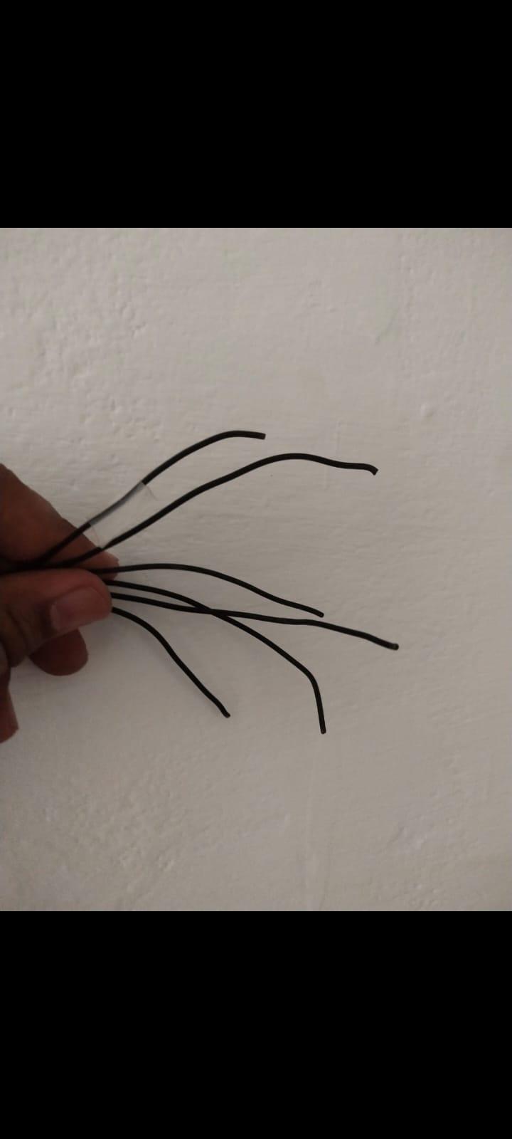

  • Strip the wire about 1.5cm from one end, Start sticking two parallel wires from the bottom of musical note.
  • Make sure exposed part of wires do not touch each other there should be some gap in between them.
  • Stick the Black hookup wires along the black lines of the design using Super Glue, so the wires wont be visible from distance
  • Leave extra wire hanging at the opposite end as shown in picture

  • Strip all the wires as shown in pictures
  • Connect one wire from pair of each parallel wires from different notes together to black alligator connector. this will act as a ground wire, which will be connected to ground/earth connector on makey makey board.
  • Connect all the remaining wires to different alligator wires then to makey makey board on Up/DOWN/RIGH/LEFT/SPACE connectors on makey makey board.(no particular order)

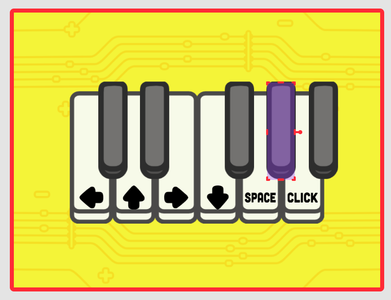

  • Open any internet browser on your computer and open this Makey Makey Piano App
  • When you touch musical notes on a wall, you touch two exposed parts of wire together, you are basically acting as a conductor and completing the circuit and sending the signal to computer through makey makey board.
