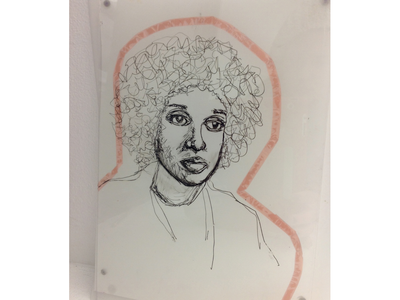

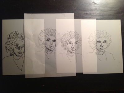

If your sound does not work check out the trouble shooting page on Sparkfun page. If it works you need to now draw your portrait of the person. I chose to use Dular .005 matte film finish and speedball pens.

I decided that one way to enclose the Lilypad was to use a small Sparkfun box that I already had. I cut two slits in the box. Each one measured out so that the plexiglass fits in the slits securely. Make sure that the space between the two piece is about 1/4 to 1/2 an inch so that they can connect. Test to make sure it can stand up.

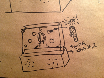

Step 9: The Interaction.
It is always good to draw out the interaction you want. Notice that the second panel is determined based on figuring out the interaction.
