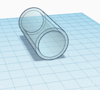

Step 2: Creating Attachment Sites
Next, you will need to create attachment sites on the cuff for the cutlery to be inserted into. There are several ways to accomplish this, however, for this example we will start with a Bent Pipe shape, found under shape generators.
Then, set the measurements as follows:
Pipe Shape: Circle
Hole Shape: Circle
Outer Pipe Width: 25 mm
Wall Thickness: 2 mm
Arc Diameter: 30 mm
Bend Angle: 0 mm
Lead-In Length: 77 mm
Lead-Out Length: 20 mm

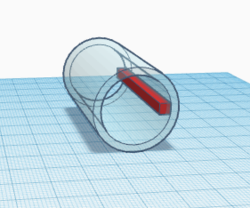

Step 3: Adding a Lock to Your Attachment Sites
Next, you will need to add a sort of "lock" system to your attachment sites, to ensure that your utensils are not spinning around during use.
You will begin by dragging a Box onto the plane from the basic shapes category.
Give the Box the following measurements:
Radius: 0 mm
Steps: 10 mm
Length: 50 mm
Width: 3 mm
Height: 3 mm.
After you have adjusted the measurements of your Box, you will click on the Box, and then the small cone icon above the shape, this allows you to lift your shape up off of the plane. Drag your shape 10 mm up from the plane. Next, you will adjust the Box against the right side of your tube, as shown in the photo above.
After you have adjusted the piece as desired into the Tube, to make this piece solid, highlight the entire shape with your cursor and then in the top tool bar select the group option. This can also be done by clicking Cntrl + G on your keyboard.
