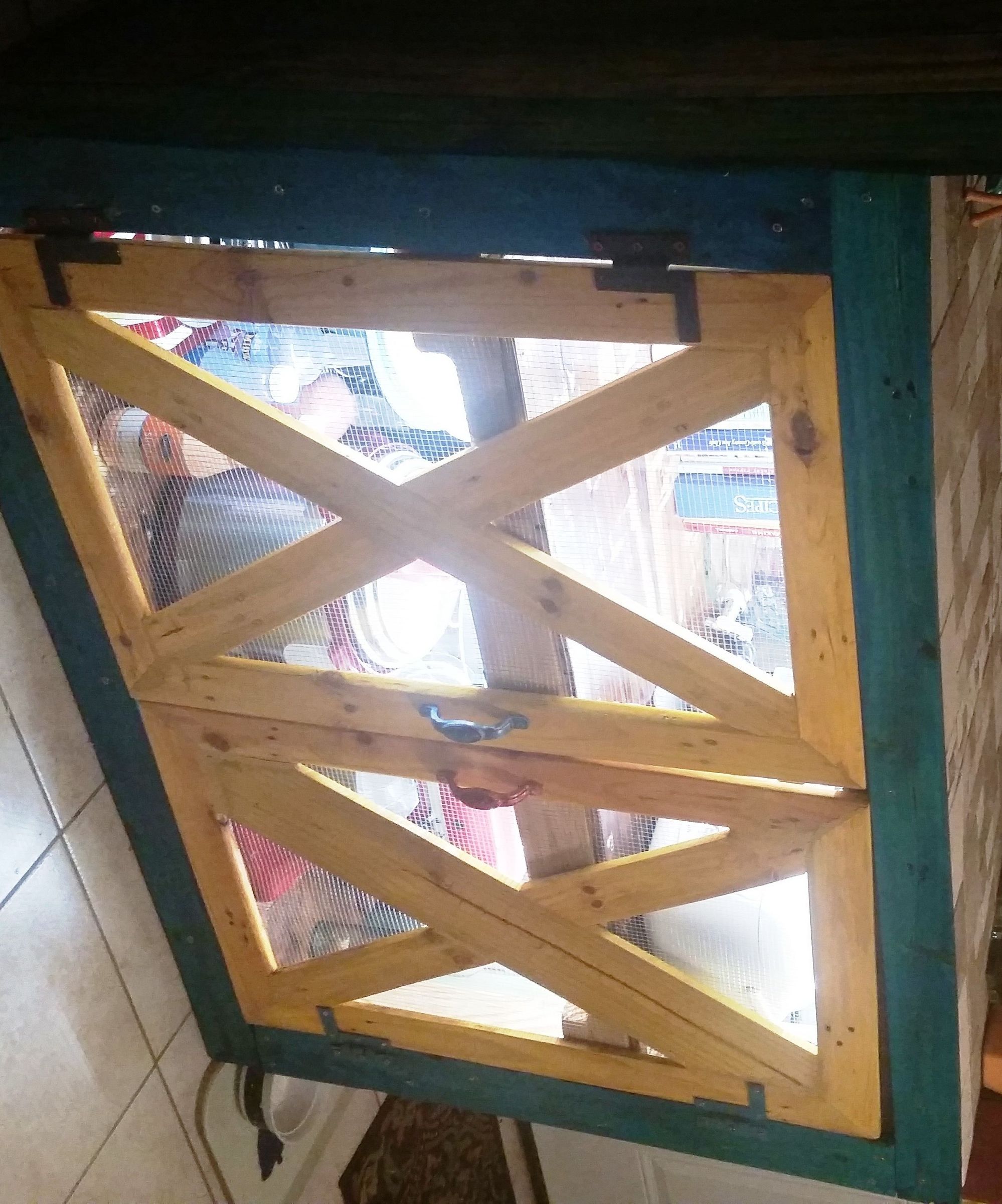

So I decided to use grey to do the trim on the doors, and stained that, attached it, then attached the handles, and then varnished both doors with several coats of MinWax Satin Polyurethane Varnish.

Doors closed. The one picture is not true to the color but the one with just the top showing is the real color. The perils of taking pictures with two different cameras.....
