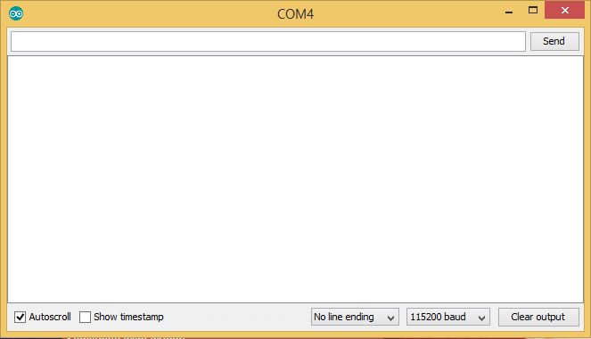

Hi Modi, I do exactly what you say in this post and i have done uploading. Then, i have this problem in the following picture. Btw, thank you for this great project. Hope to see your reply soon.
Reply 3 years ago
Hello,
please first open Serial monitor and then upload the firmware. Right after upload NodeMCU will send data to monitor
do not forget to set right band 115200
Reply 5 years ago
Please change the baud rate of serial monitor to 115200

Changed the baud rate to 115200, no change. serial monitor is blank.

Nice Tutorial. NodeMCU get connected to Hotspot but there is no data shown on serial Monitor.
4 years ago
Hello, modi. 1992.
I have done all such things and connected my nodemcu with my mobile hotspot, but in serial monitor of Arduino ide is not show anything.
