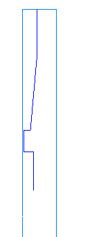

  • Create a Turn Feature
    • Geometry from revolved boundary
    • Chain curve from geometry
    • Extend Curve to stock edge
    • New turn feature
    • Offset location: 0

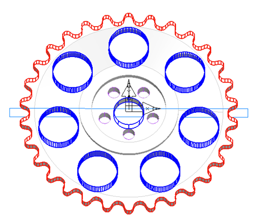

  • Create a new Turn/Mill feature
    • ‘Extract with feature recognition’
    • Side Feature
    • ‘Along the setup z axis’
    • ‘Automatic feature recognition’
    • Press Next, any potential side features should be highlighted
    • Click on the side feature representing the gears
    • Press Finish
    • Create a new Pocket Feature
      • ‘Extract with Feature Recognition’
      • Pocket feature
      • ‘Along the setup z-axis’
      • ‘Automatic Recogntion’
      • Select the recognized pocket feature
      • Finish
Now with the center of our part machined, let’s create a few additional pocket features to machine the larger holes around the OD of our part.
    • Create another new Pocket Feature
      • Pocket feature
      • ‘Select side surfaces’
      • Select the cylinder walls that make up these seven pockets
      • Leave the remaining dimensions/strategies as default
      • Finish
· Create a new Hole pattern
  • Create a new Hole pattern
    • Select ‘Extract with feature recognition’
    • Select ‘Hole’ and then press Next
    • Select ‘Along the setup z axis’ and then Next
    • Select ‘Recognize and construct multiple holes’
    • Select ‘Exclude holes with diameter:” and greater than 0.75”
    • Press Next
    • Press ‘Select all’
    • Finish
This will create a pattern feature containing all the holes with a diameter less than 0.75.
