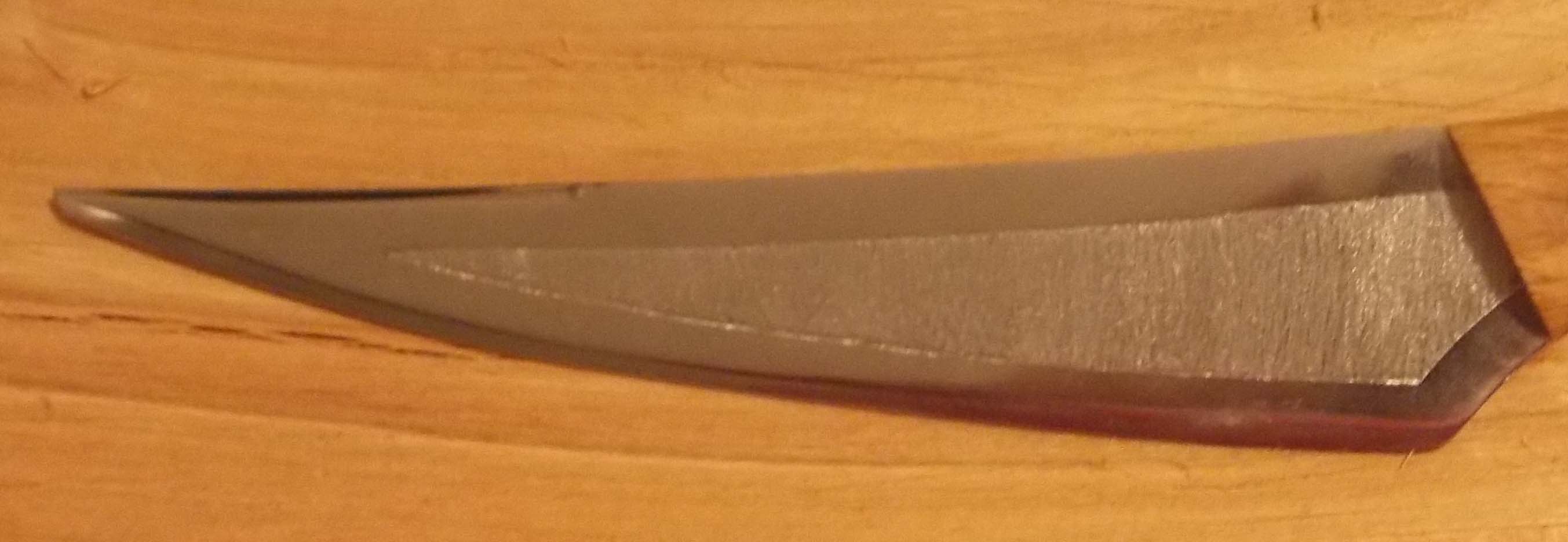

Step 14: It Is Finished
Tools And Material Required
Quality Varnish
400 Grit Sandpaper
Finish the stand with at least three coats of varnish, sanding lightly between each coat. Now I have a display that is sort 'a invisible - you cannot see the support at least.
The 8 5/8" knife is made from 1/8" stainless steel, with a cocobolo handle and brass pins.
