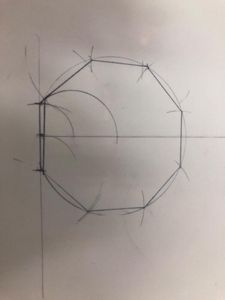

Step 1: 1. Draw and Cut an Octagon and Rectangles on Polypropylene
Draw a regular octagon with a compass (
) or protractor (135 degrees) making each length 4 cm
Draw 8 rectangle with one side as 4 cm and the other side 14 cm
Then cut them out with scissors or a cutter knife
