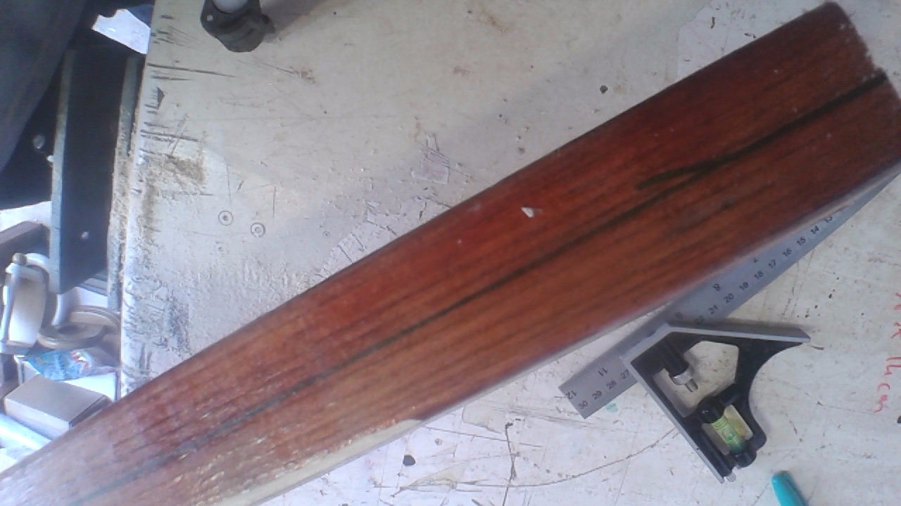

Step 1: Cut & Rip
I started with an offcut of 2x4. I cut it down to a length i thought would be good and ripped it in half.
