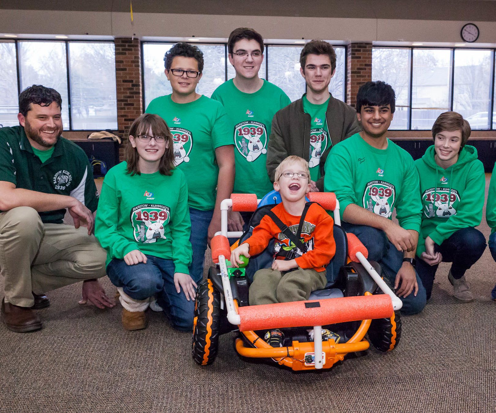

  • A PVC exoskeleton backed with pool noodles for cushioning.
  • A kickboard to the back of the seat to increase back support for the child OR a harness for the child.
  • Converting the acceleration mechanism from a pedal to a button placed on the steering wheel.
  • Adding a kill switch to the back of the vehicle.

  3. To attach the PVC structure to the vehicle, insert the PVC structure into the 4 holes in each of the corners surrounding the seat. Use the 4x 1.5 in. wood screws to attach the PVC frame to the car by drilling through the plastic shell and into the PVC. Using a pilot hole is recommended. For reference, consult image 2.
  4. Use the wood screws to secure the PVC structure together. Drill a wood screw at every attachment between a piece of PVC/CPVC and connector.
  5. Attach 4 pool noodles to the PVC sections that act as seat handles, as shown in image 3.
  6. Based on what suits the child best, select one of the following two options:
Option 1: Boogie Board
Drill 4 holes in a rectangle into the boogie board, and use zip ties through these holes to secure the boogie board against the PVC exoskeleton. Consult image 4.
Option 2: Harness
Place a pool noodle on both the top and bottom PVC crossbar at the back of the truck. Zip tie these pool noodles into place. Secure the harness by wrapping the harness bands around the pool noodles or using velcro. Consult image 5.
