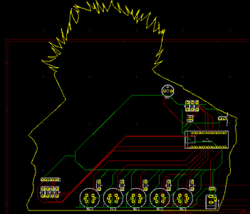

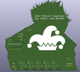

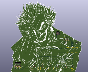

Step 2: Designing and Soldering the Joker Remote Gas Station PCB
Before prototyping my PCB design, I tested all connections and wiring with the Arduino Nano on the breadboard.
Then, I designed the Joker Remote Gas Station PCB by using KiCad. I attached the Gerber file of the PCB below, so if you want, you can order this PCB from PCBWay to create a fitting and apt apparatus to observe the presence of hazardous gases and get notified when they reach dangerous levels - inspired by malicious Joker :)
Click here to inspect and order this PCB directly on PCBWay.
First of all, by utilizing a soldering iron, I attached Arduino Nano, IR receiver module, MQ-2 gas sensor, MQ-3 gas sensor, MQ-4 gas sensor, MQ-6 gas sensor, MQ-9 gas sensor, headers (female), buzzer, 5mm common anode RGB LED, 220Ω resistors, 20K resistors, and power jack.

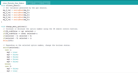

⭐ In the collect_Data function, get gas measurements produced by MQ series gas sensors - MQ-2, MQ-3, MQ-4, MQ-6, and MQ-9.
void collect_Data(){
  // Get variables generated by the gas sensors.
  mq_2_val = analogRead(mq_2);
  mq_3_val = analogRead(mq_3);
  mq_4_val = analogRead(mq_4);
  mq_6_val = analogRead(mq_6);
  mq_9_val = analogRead(mq_9);

⭐ In the change_menu_options function, increase or decrease the option number by using the IR remote control buttons - Up and Down - to switch between menu options on the interface.
void change_menu_options(){
  // Increase or decrease the option number using the IR remote control buttons.
  if(IR_codeValue == up) selected--;
  if(IR_codeValue == down) selected++;
  if(selected < 0) selected = 5;
  if(selected > 5) selected = 1;
  delay(100);

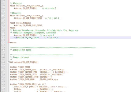

Step 5: Fixing the Timer0_pin_port Error
Unfortunately, when using the IR remote library and the tone library, the Arduino IDE throws the timer0_pin_port error. The error occurs because both libraries try to use the timer by declaring the same name - Timer2.
To fix this issue, open the boarddefs.h or IRremoteBoardDefs.h file depending on the IR remote library version. Then, change IR_USE_TIMER2 to IR_USE_TIMER1 for Arduino Nano.
