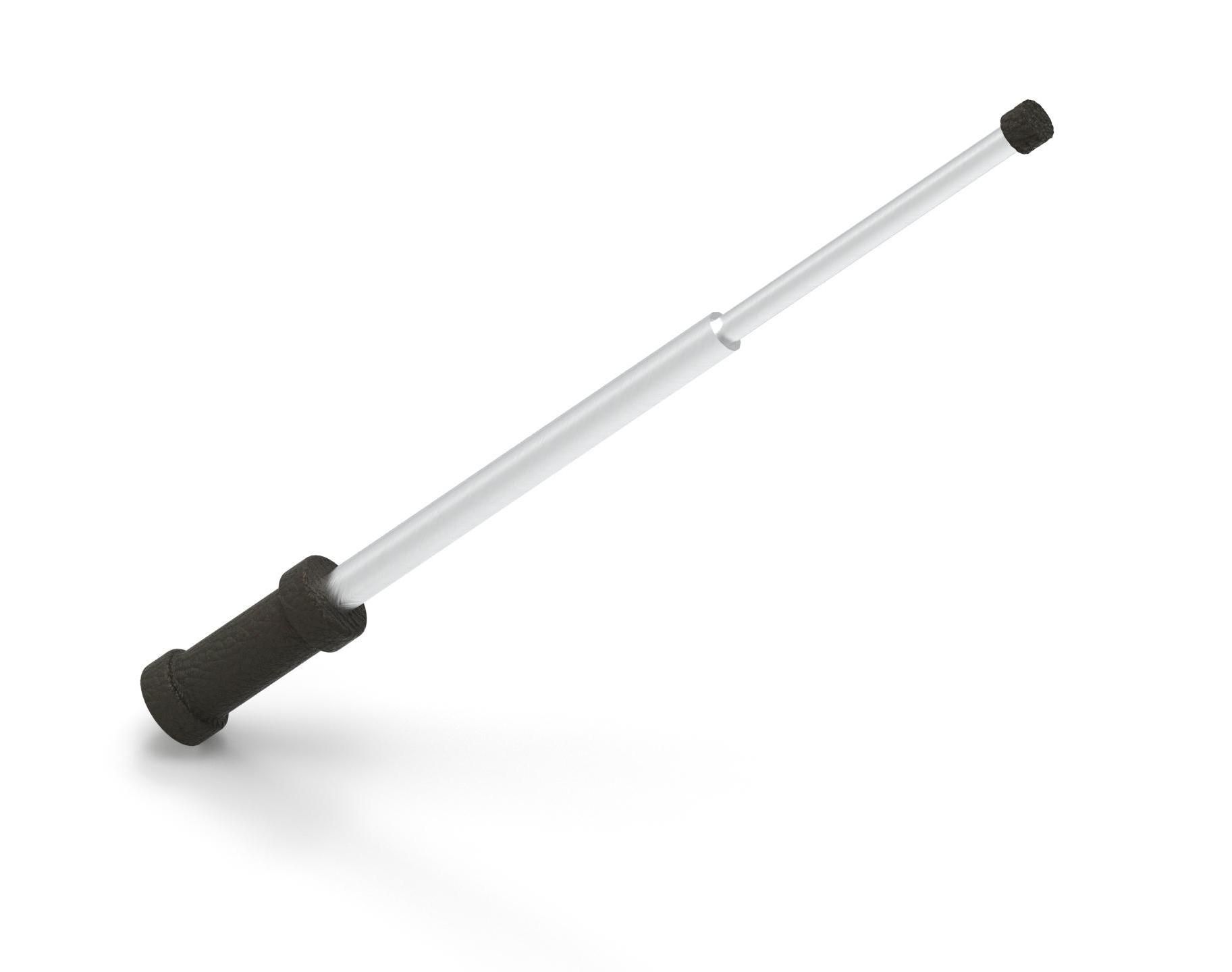

Step 2: Bearing
  • place the bolt, bearing and nut as in the first photo
  • slide the bearing over the bolt
  • tighten the nut around the bolt
  • if necessary, tighten it a little with a spanner
  • if your result is the same as in the last picture, you are doing well

Step 4: Connection Piece
  • take the support out from the connection piece of the selfie stick
  • remove the support using a tool you find easy (e.g. small pliers), the connection piece should be hollow
  • now clamp the piece between a vice (not too hard so it doesn't break)
  • now screw in the (insert) thread
  • screw it in using a tool (e.g. a metal strip)
  • turn until you can go no further
Step 5: Wooden Ball
  • take the wooden ball, the selfie stick and the bolt
  • clamp the ball with the vice and drill a hole the same diameter as the bolt
  • screw the bolt into the ball
  • if necessary, tighten it a little with a screwdriver

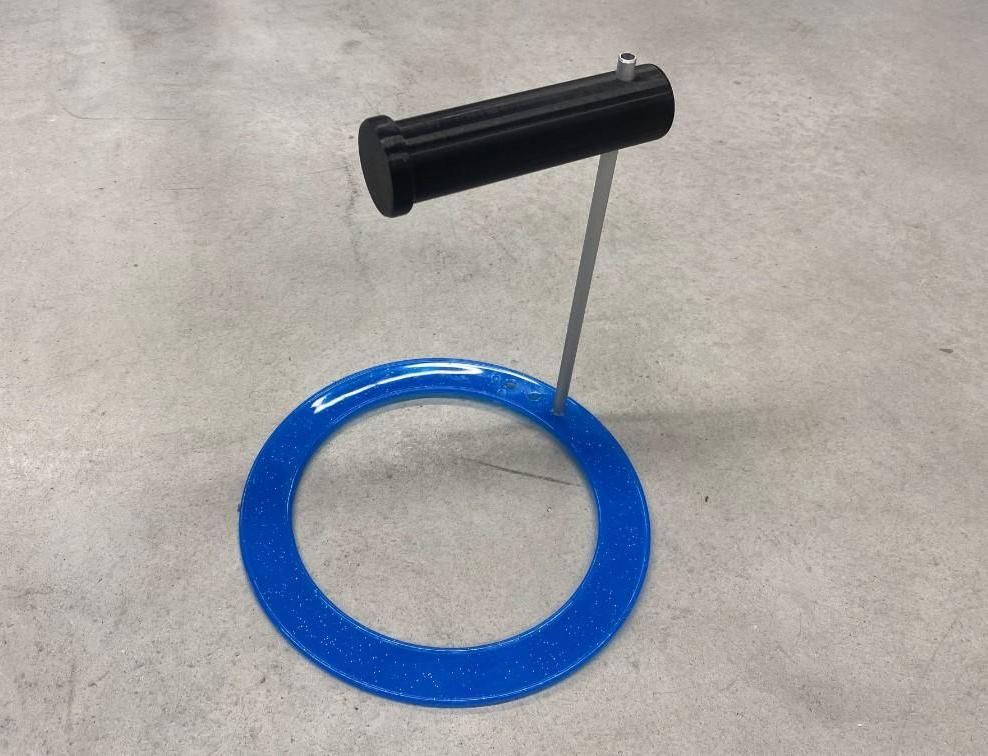

Step 6: Merging
After these four separate steps, we can start putting everything together.
  • take the bearing and the ring
  • place the bearing in the hole of the ring
  • slide the 3D printed clip over it (make sure it doesn't go outside the ring)
  • use the marker to mark where the four screws will go
  • drill four holes near the dots (the same diameter as the screws)
  • screw the screws into the holes
  • turn the ring and slide another clip over the four screws
  • now screw the four (cap) nuts over the screws
  • the largest bolt (the one from the bearing) sticks out at one side
  • screw the connection piece onto it
  • now we can also attach the selfie stick to the connection piece
  • screw a bolt through the connector and the selfie stick, don't forget the washers
  • tighten with a wing nut
