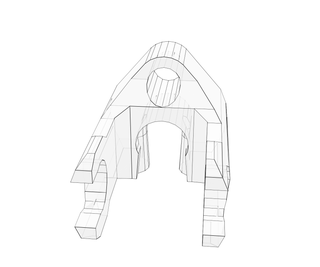

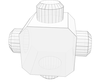

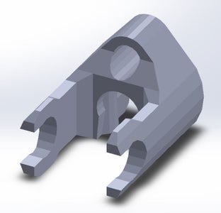

Step 3: 3D Printed Piece
Note: The file for the pieces can be found on the end of this Step (as .stl files)
Well, there's not much to say about this. There were some versions of it, 4 to be precise, before I got the actual shape of the hinging part right. It's fragile to put together, but works as it should.

Oh! one other thing. You said that the 3d printed universal joint can't handle a lot of torque, what gives first? The 3d parts connection or the brown connector? If the brown connector is coming off than just add another brown connector behind and perpendicular from the first. The notch on the one connector behind the front one makes it harder for the brown connector to come off. (learned this from knex gun applications and elastic powered car applications)
0
GWorks
GWorks
Reply 7 years ago on Introduction
I've added a pic of the final design. If you see those small clips, those will break off first. This has also to do with the way the piece was printed: standing. Why was this done? To get less support material (inside the holes) So... the layers in those clips are in a not so strong position. In all the last designs, one or more of those clips broke off. The original k'nex pieces are injection-moulded.

Well I see what will break off now, and unfortunately my reinforcement technique assumes the brown connector is the weakest link so that won't fix it.
As to reinforcing the part more maybe add some ribs to the outsides of the forks that go from the tips to the base. You'll lose some flexibility in but gain strength. Also you may try bulking up the forks a bit, I know you were aiming at small, but even adding an 1/8th of an inch overall will still produce a smaller component than the knex built version.
Did you use Autodesk inventor to model this part? If so may I have a copy of the file so I can show you what I'm talking about?
