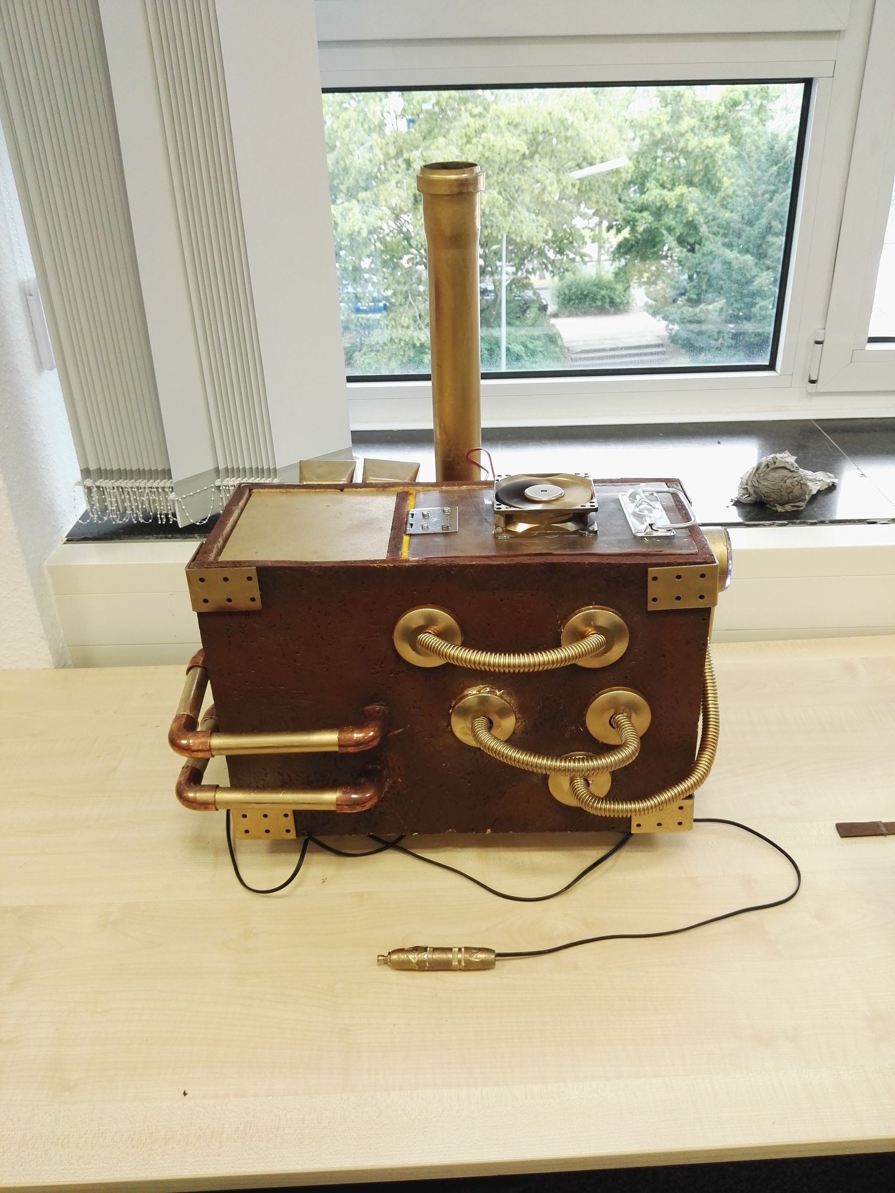

kaSTAN is a beer box... that is also your friend! Though it might insult you from time to time, it'll always inform you about what's going on inside of him honestly and immediately. Even when you're not home, you can keep in touch with him via twitter or a website.

We combined a temperature sensor and for every bottle slot one force sensor. Everything is controlled by the arduino and sent to its serial output. The raspberry, as configured above, reads those JSON-formatted data and is doing the rest.
Copy the attached script onto your Arduino and you're done. Now, prepare a breadboard like the attached sketch. Make sure you connect it exactly as it is sketeched on the example. Connect the Raspberry Pi via Serial USB to your Arduino and you're done.
Step 17: Build It!
Follow the steps in the instructions to build kaSTAN (see pdf file below).
