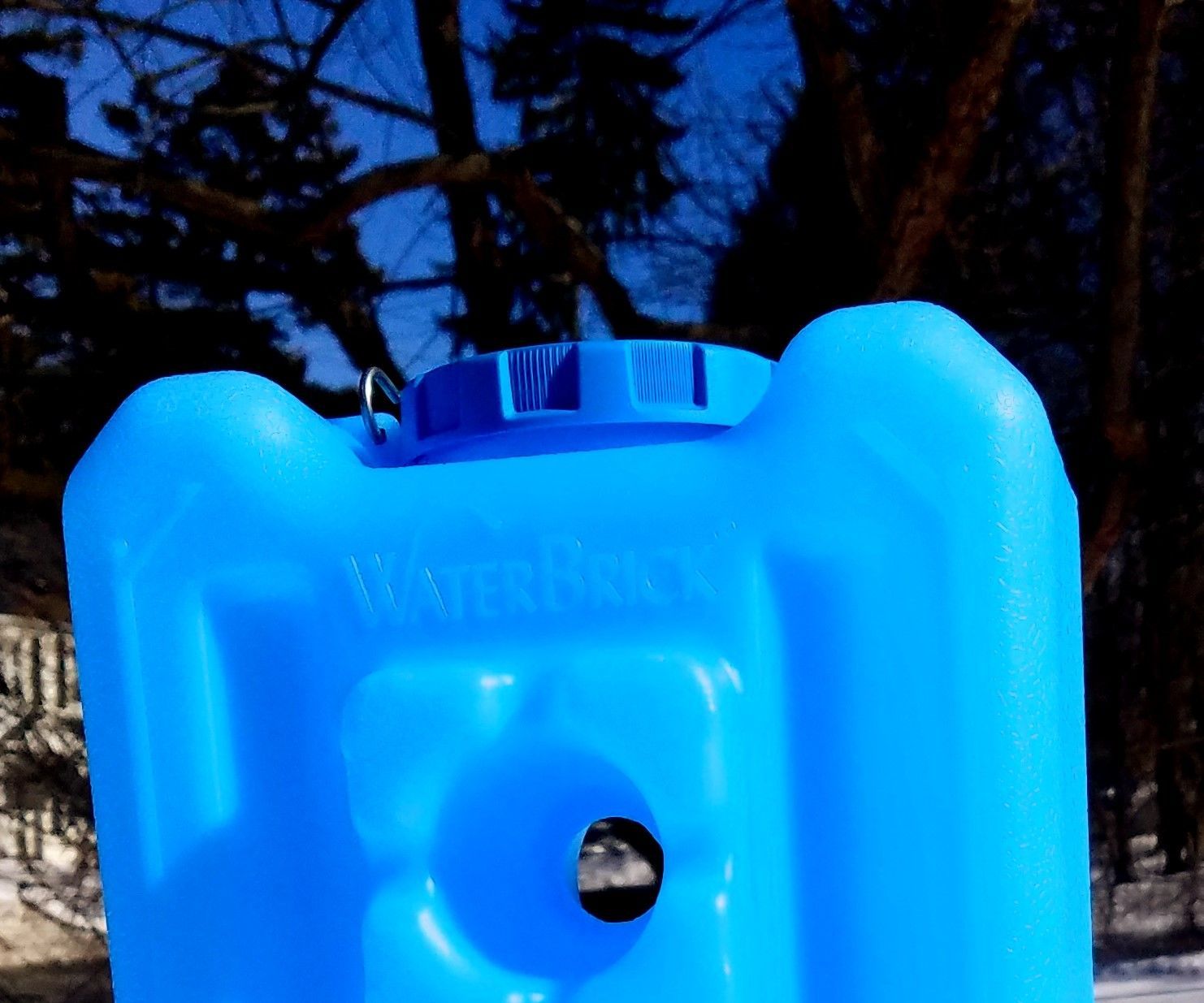

Also in the picture:
  1. Instruction and care manual held by me
  2. Blue water brick
  3. Clear water carrying pouch
  4. Red drinking cup
  5. Clear drinking glass
