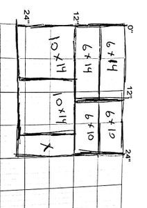

Step 2: Measure
To create the box you need to cut 6 pieces out of the plywood.
2- pieces that are 6" x 14" - these will be 2 of the sides
2- pieces that are 6" x 10" - these will be the other 2 sides
2- pieces that are 10" x 14" - these will be the bottom and lid
Map out the best layout on the plywood - See rough sketch provided.
Make measurements with tape measure. Make a mark on each side of wood and use the straight edge and pencil to draw the lines.
As an optional step you can put masking tape on the lines where the wood will be cut - this will prevent "blow out" and makes for a nicer finished product.
