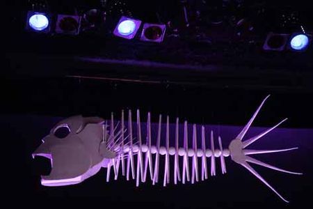

This project was specially designed to integrate the setting of the show "Fear Street." This is a skeleton of fish, two feet long, eighty centimeters tall and two feet wide. The structure of the object is made entirely of cardboard. Backbone of an animal is elastic and its vertebrae were made with polystyrene balls. The fish will be suspended by a nylon thread and a motor with an unbalanced weight on the shaft will be responsible for inducing the movement of swimming.

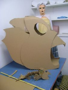

Step 2: Modeling the Fish

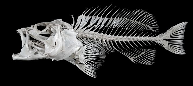

The first thing I did was look for a clear model for making the fish. I needed an animal scary and imposing. I remembered the fish that Americans call BASS, known in Brazil by Robalo. I found this site http://www.helterskeletons.com/ with various models of fish skeletons. The skeleton of the Largemouth Bass was exactly what I wanted.
Became the bone structure of the skeleton into something easier to work with cardboard and the result was this:
A primeira coisa que fiz foi buscar um modelo nítido para a confecção do peixe. Eu precisava de um animal assustador e imponente. Lembrei do peixe que os americanos chamam de BASS, no Brasil conhecido por Robalo. Encontrei esse site http://www.helterskeletons.com/ com vários modelos de esqueletos de peixe. O esqueleto do LARGEMOUTH BASS era exatamente o que eu procurava.
Transformei a estrutura óssea do esqueleto em algo mais fácil de se trabalhar com o papelão e o resultado foi esse:

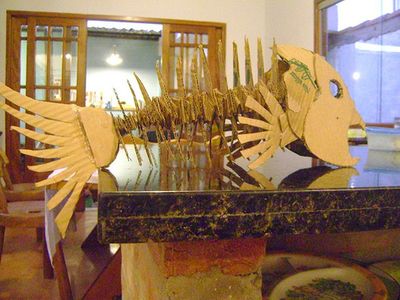

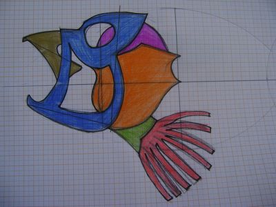

The tricky part was to model the bone structure. I tried using Google Sketchup, but could not reason using the program and the result is that I decided to do the drawing manually on graph paper and then went directly into the cutting board, riding the missing pieces to add volume to the fish.
I managed to do this on a small scale prototype using a cardboard box that was the recycling bin from my house. It cost me a day work. prototype allowed me to see where the structural reinforcements were needed.

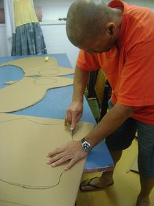

A parte complicada foi modelar a estrutura óssea. Tentei usar o Google Sketchup, mas não conseguia raciocinar usando o programa e o resultado é que resolvi fazer o desenho manualmente em papel milimetrado e depois fui cortando diretamente no papelão, montando as peças que faltavam para dar volume ao peixe.
Consegui realizar esse protótipo em pequena escala usando uma caixa de papelão que estava no lixo reciclável de minha casa. Isso me custou um dia de trabalho.O protótipo me permitiu enxergar onde seriam necessários os reforços estruturais.

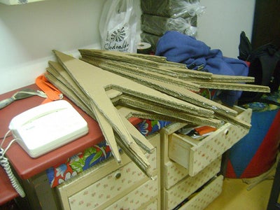

Step 4: Doing It Big!

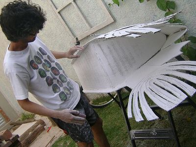

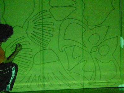

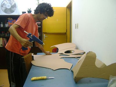

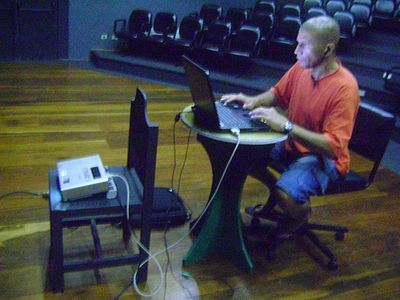

I sent the drawing to a friend who scanned. Then, using a laptop and a video projector, we project the drawing directly on the cardboard sheets. We try to optimize the most space because I already predicted that the backbone of the fish would be the critical element of the project. I would have to assemble a sandwich with layers of cardboard.
With the design projected on cardboard, scratched traces using pencil and ruler. Then cut out the pieces with the blaze and assemble the structure, using hot glue. First the head and then the rest of the spines.

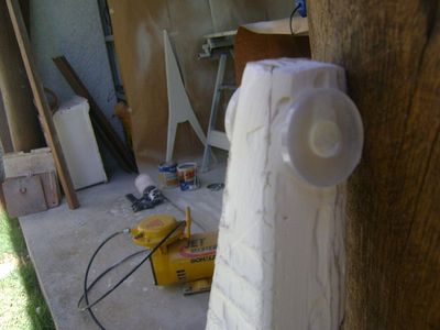

The way the fish will be suspended by a nylon thread worried me, mainly because we are working with cardboard. I drafted this enhancement to run wires, using shirt buttons glued.
Enviei o desenho para um amigo, que o digitalizou. Depois, usando um laptop e um projetor de vídeo, projetamos o desenho diretamente sobre as folhas de papelão. Tentamos otimizar ao máximo o espaço porque eu já previa que a espinha dorsal do peixe seria o elemento crítico do projeto. Eu teria que montar um sanduiche com várias camadas de papelão.
Com o desenho projetado nas folhas, riscamos os traços usando caneta e régua. Depois recortamos as peças com estilete e montamos a estrutura, usando cola quente. Primeiro a cabeça e depois o restante das espinhas.
O modo como o peixe ficará suspenso por fios de nylon me preocupava, principalmente porque estamos trabalhando com papelão. Elaborei esse reforço para passar os fios, usando botões de camisa colados.

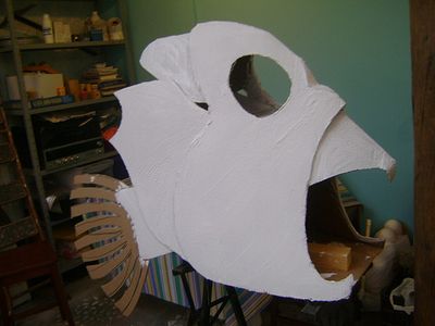

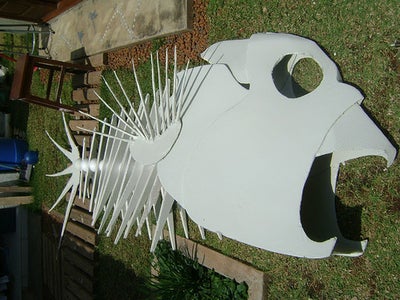

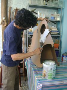

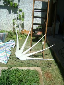

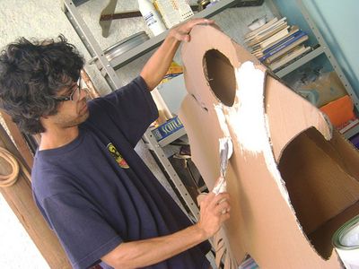

Step 5: Plaster, Sand, Paint

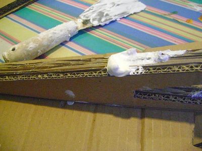

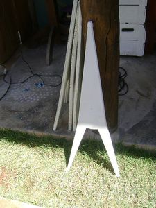

Next, we turn to plaster, to remove the imperfections. This step was necessary because we wanted to take a more careful finish the fish. Lots of sanding and cleaning and then have the fish entirely white.
Then I painted the fish, using an air compressor. My idea was to leave you with these colors, I discovered in my research on the skeleton of fish. This image was obtained with a contrast chemical inserted into the fish before performing a scan. The effect is very pretty. Darker than the contours in the center. The lighting in the theater will give the effect of this contrast.
Em seguida, recorremos à massa corrida, para eliminar as imperfeições. Esse passo foi necessário porque queríamos dar um acabamento mais cuidadoso para o peixe. Muita lixa e limpeza em seguida e temos o peixe inteiramente branco.
Depois eu pintei o peixe, usando um compressor de ar. Minha idéia era deixá-lo com essas cores, que descobri na minha pesquisa sobre o esqueleto dos peixes. Essa imagem foi obtida com um contraste químico inserido no peixe antes de se realizar uma tomografia. O efeito é muito bonito. Mais escuro nos contornos do que no centro. A iluminação no teatro vai dar o efeito deste contraste.

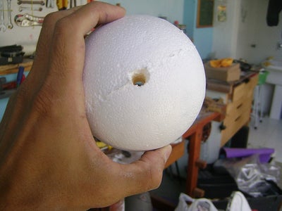

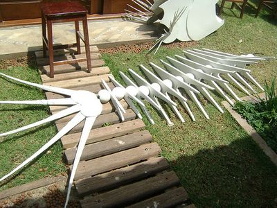

Step 6: Mounting

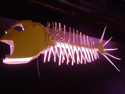

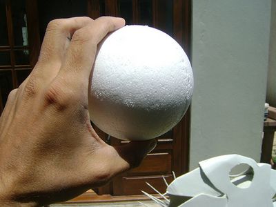

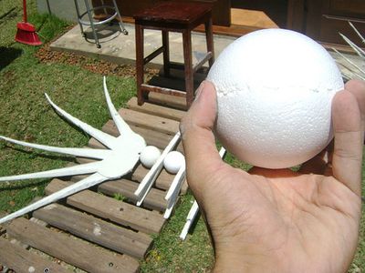

After it was necessary to put the pieces together. A "cord" of the animal is made of elastic, to allow easy movement. The "vertebrae" are balls of Styrofoam. First we have to stick all the balls of Styrofoam and the vertebrae in position. I made a table with measurements of the prototype. It helps me find the exact spot where you should take the elastic, so that the profile drawing of the fish corresponds to the model. The rubber band should be taut.
Depois era necessário juntar as peças. A “medula” do animal é feita de elástico, para permitir a movimentação. As “vértebras” são as bolas de isopor. Primeiro temos que furar todas as bolas de isopor e as vértebras na posição certa. Fiz uma tabela com as medidas do protótipo. Isso me ajuda a encontra o ponto exato onde deve passar o elástico, para que o desenho do perfil do peixe corresponda ao modelo. O elástico deve ficar bem esticado.

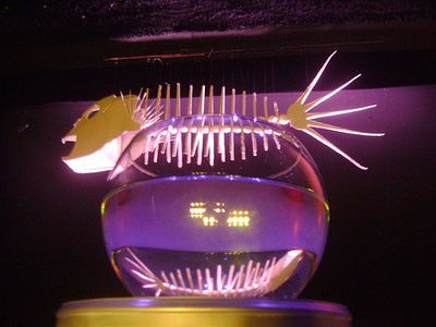

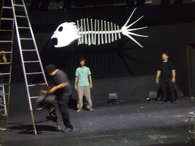

The interesting structure is that any move made in one of the spinal reverberates the entire structure. To perform the swimming movement of fish, I want to put a motor in the head with an unbalanced weight on the shaft, the same system used on vibrate mobile phones. This should induce a lateral motion of the head that will reverberate throughout the animal's body.
O interessante na estrutura é que qualquer movimento realizado em um dos pontos da coluna vertebral reverbera para a estrutura inteira. Para realizar o movimento de natação do peixe, pretendo colocar um motor na cabeça, com um peso desbalanceado no eixo, o mesmo sistema utilizado no vibracall dos telefones celulares. Isso deve induzir um movimento lateral na cabeça que vai reverberar por todo o corpo do animal.
