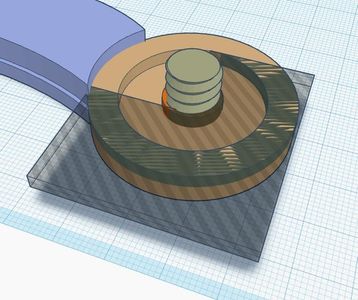

Picture 6. This shows the beginning of fashioning the actual part which holds the blade. In picture 6, I first cut out a cylindrical shape, into which I will construct the blade holder. Picture 7 shows the result.
The secateur blade is to be held onto the handle by means of a large threaded locking nut which is tightened onto a robust thread.
The thread, shown in Picture 8 is borrowed from a Thingiverse file  -  ‘G-Clamp, fully printable,’ by Johann517  -  thank you Johann.
Picture 8 shows the beginning of the blade holder which is to be refined in later processes. Picture 9 shows the method of ‘cropping’ the thread to the length I wanted, with the result in Picture 10.
Pictures 11 and 12 show the first step to making the recess for the pivoting hole in the secateur blade.
Picture 13 shows how the space for the blade is carved out of the rough holder shape.
Picture 14 shows the finished holder, in position where it will eventually be joined to the handle section.
