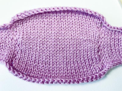

Step 1: The Pattern.
This pattern uses the stockinette stitch. If you aren't familiar, check out this beginner's Knitting class here on Instructables.
The kitted mask shape is achieved by "turning around early" and not knitting the 8 outermost stitches on every other row. With fewer rows of stitching on the outside than in the center, there is more volume in the center to give space for your nose and chin.
Cast on 40 stitches using your favorite stretchy cast-on.
Row 1:
  • Knit across
Row 2:
  • Purl the first 32 stitches, then STOP
  • Turn the knitting around (you won't be finishing the row)
Row 3:
  • Knit the middle 24 stitches, then STOP
Row 4:
  • Purl the 32 stitches to the end of the row.
Row 5:
  • Knit across all stitches
Repeat rows 2-5 until the mask is large enough to cover your disposable mask or filter.
Cast off with your favorite stretchy cast-off.
To make ear loops, create a chain stitch with yarn, or tie elastic to the ends of the mask cover. You're ready to stay stylish and warm this winter!
