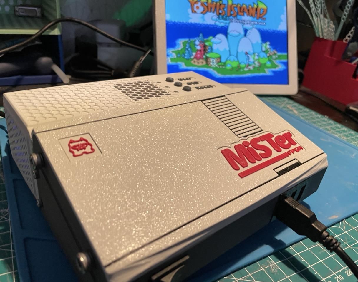

Kubic is an ITX PC case designed to be printed on smaller 3D printers, such as a Prusa Mini or a Bambu A1 Mini. The larger parts take 170 x 170 mm, which means they fit nicely on 180 x 180 mm beds.
It takes design cues from the classic computers, such as NEXT machines, or older Power Mac G4 Cube from the early 2000's. The handle also reminds a bit of the venerable Nintendo GameCube, while ensuring that the upper heat exhaust remains clear. "Classic vibe" is definitely a defining word here.
The case can house a full ITX PC build, including a discreet GPU up to double slot and 220 mm long. You won't fit larger cards in there, but it's enough for quite a few cards available on the market today. Cooling is ensured by a 140 mm chassis fan (up to 30 mm thick) mounted on top. It takes fresh air from under the case (hence the feet) and it exhausts the heat through the top. My tests resulted in good cooling performance despite the single fan, stabilizing the CPU temp at 94° C and GPU at 75° C in an absolute worst case scenario (both CPU and GPU maxed out for two hours). Ingame, I never went north of 75°C for both CPU and GPU. The case also has enough space to fit a pretty massive CPU cooler, which could even improve thermal performance over my own tests.
