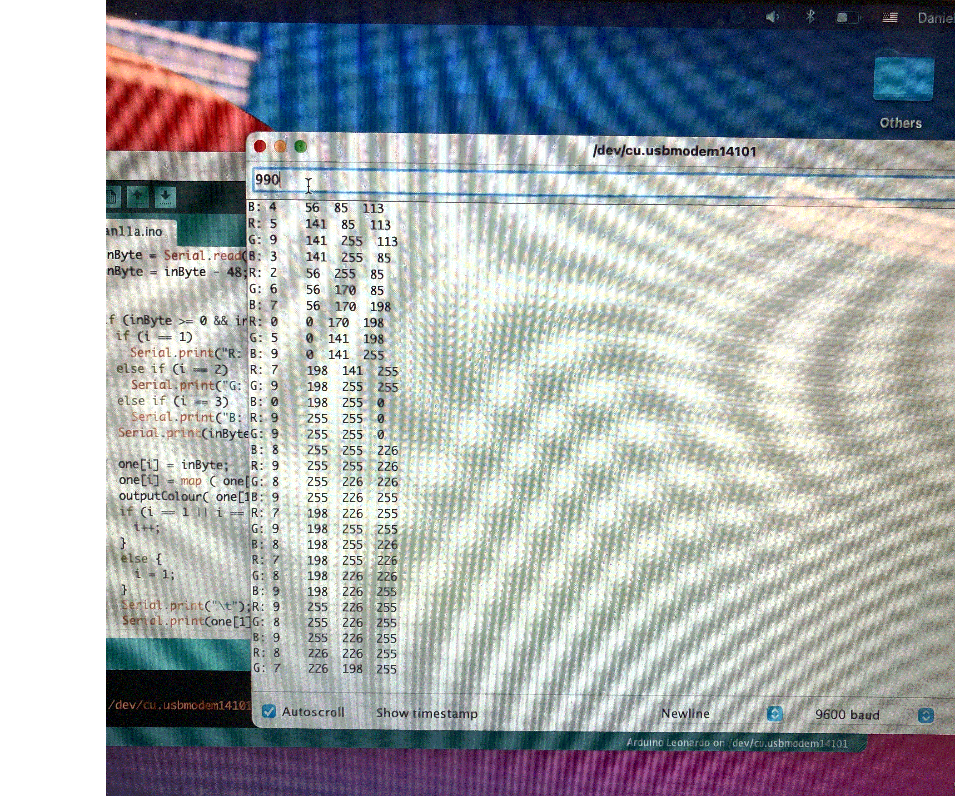

I will today tell you how to control a RGB LED with help of Arduino and Processing language. This is my first instructable So, please let me know if I could anything improve and if you have any kind of questions leave them in the comment box, I would love to answer them.
Simply you need the following items for this sweet little project.

Step 1: 程式碼
// Output
int redPin = 9; // Red LED, connected to digital pin 9 int greenPin = 10; // Green LED, connected to digital pin 10 int bluePin = 11; // Blue LED, connected to digital pin 11
long int inByte; int wait = 10; //10ms
void setup() { pinMode(redPin, OUTPUT); // sets the pins as output pinMode(greenPin, OUTPUT); pinMode(bluePin, OUTPUT); Serial.begin(9600); }
void outputColour(int red, int green, int blue) { analogWrite(redPin, red); analogWrite(bluePin, blue); analogWrite(greenPin, green); }
int* getColour() { int* colour; int i; i = 0; //for some reason it only works if we put a dud value between the C and // the R value while (i < 4) { if (Serial.available() > 0) { colour[i] = Serial.read(); i++; } }
