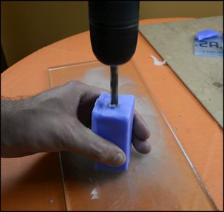

Step 5: For the Base
I drilled holes for LED's and the switch.
I soldered LED's and a switch to the battery holder.
Then I glued the switch to the case and inserted LED's.
