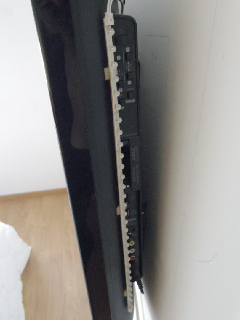

I used a strip with 30 LED's and place two strips one on both sides of the TV but you can place more for a bigger effect.
This LED strips are easy to place because they have plastic bracket that glues on the TV.

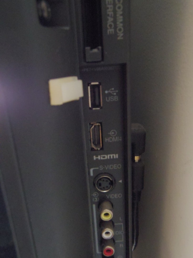

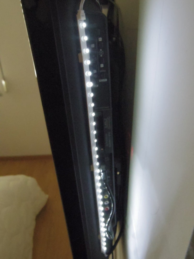

When the TV is turn on it gives 5V out by the USB connection triggering the 4N25 turning on the lights.
The LM338 allows you to dim the lights at your taste by the 5k potentiometer.
There is a small delay on the output of the 5v by the TV when it turns on and off but it's not a big deal.
