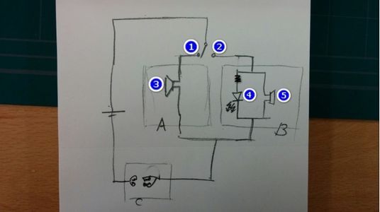

Step 1:
1. The A block checks the disconnection .
• Switches are connected to 1 terminal.
2. The B block is checked the LED and buzzer .
• Switches are connected to the 2 terminals.
• The crocodile clip of the C block must be connected.

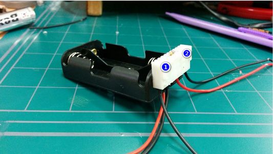

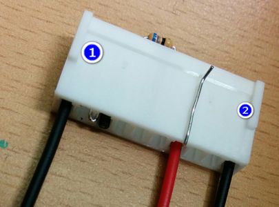

Step 2:
  1. Insert the pin into the Molex.
  2. Use nippers cut the pin .
  3. Insert the resistor .
  4. Bend the ends of the resistor .
Step 3:
Using a glue gun.
Attach the buzzer and switch in the battery holder.

Step 7: How to Use the 'Jeolkameter'. - Disconnection
1. Disconnection
  • Place the slide switch in the direction of the arrow (left) .
  • After the "beep " sound normal , if the " silent " break
Step 8: How to Use the 'Jeolkameter'. - LED, Buzzer
  1. Place the slide switch in the direction of the arrow (to the right) .
  2. The corcodile clips to connect with each other.
  3. Plug the LED and the buzzer on the test port.
  • LED Test : (+) Is inserted into the " 3" hole . (-) is inserted into the " 4" hole .
  • Buzzer Test : (+) Is inserted into the " 1" hole . (-) is Inserted into the "2" hole.
