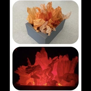

I made an LED campfire because fire is beautiful and cozy during the winter months, but fire isn't safe to be left unattended in our homes. This LED campfire allows the maker to have this warm energy available at any time, day or night.

After printing the file for the fire pit case, remove the support material. Use a plastic bottle with a flat side to cut a rectangular shape that can slide inside the 3d print. Use a hot glue gun to attach it to the top, inside of the fire pit print. This will be used to attach the paper flames in the next step. Insert the flashlight and make sure that it fits correctly.
Step 7:
Take tissue paper, tear it into small pieces and crumple it up. With a hot glue gun, attach the pieces of tissue paper on top of the clear plastic to make it look like fire. Use your own imagination and personal preference to make it look the way you like best. A good tip is, every once and a while turn on the flashlight to see if you like how it looks. Adjust as necessary.
Step 8:
Your personal fire pit is now complete! Take it into a dark room and enjoy the beautiful ambience of fire.
