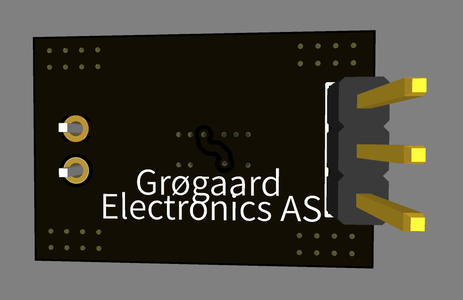

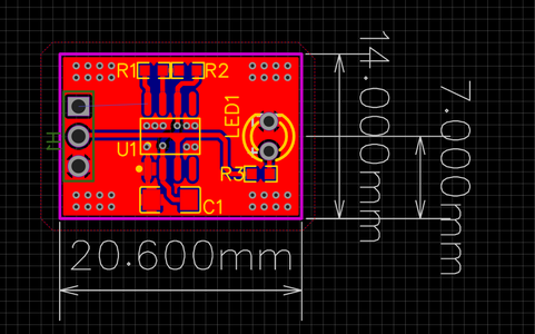

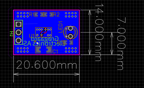

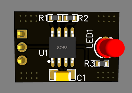

Step 2: Lets Make a PCB!
I created the circuit in a Free PCB designer called EasyEDA.
Firstly I created a schematic and used the inbuilt search engine for components and found the right components for this project.
Then I converted the schematic into a pcb using the 'Create PCB' button.
I arranged the components into the posistion i wanted them to be in and added traces between each component.
Then I added a solid GND ( Ground / - ) Layer, and some text to spice it up a bit.
Then i pressed 3d view, to view this master piece.
( In the PCB I forgot to connect the VCC pin of the header to the VCC pin of the 555-timer IC. DON'T DO THE SAME! )
