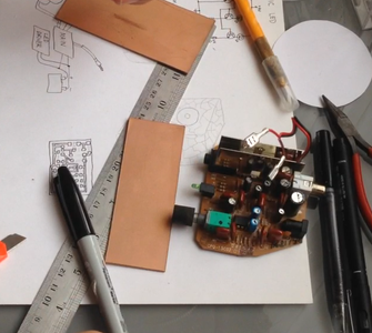

Step 7: The LED Driver Circuit
Okay, here it comes the hard part. For this step you'll need a bit of electronic knowledge, and if you don't know a lot about it, it's better you to ask for help to someone who knows more about this matter.
However, this step is optional, I wanted to make a circuit on a copper plate because that's the way I like to design my own circuits, but you can leave it done on a protoboard, or even, make your own design on any pcb software and print it. I choose the quick way to do it. Sharpie
So well the first thing to do is to design how the circuit will be, I first did it in a paper folowing the scheme (I also attached it again above), and there is something really important I need to say about this: there's a mic in the scheme but, of course, it doesn't need to be a mic, it can be any audio source. That's why we will use the source from the amplifier and instead a mic, we will use the auxiliar doing the same thing.
After that, I took a copper plate and drew the circuit with a sharpie marker and cut the copper plate at the right size I needed; of course you can just leave it in the protoboard or make it with a pcb or however way you want. But well, the next thing to do is to take some ferric acid.
What the ferric acid does, is to eat all the copper that does not have sharpie, so that's the way how the circuit will be drawn with the copper. The way I do it, is with a light bulb...so that way I'll have a bit of heat and the acid will react faster against the copper. So I put the acid inside a plastic jar and then put the copper plate inside it. And what's next to do, is to shake the jar softly (trying not to drop it because it's easy to get things ruined with it, be careful), and shaking the jar plus the little heat from the bulb will make the acid to eat the copper faster than normally.
So once you can see that there's no copper anymore, you can take out the copper plate from the acid, then wash the copper plate and DO NOT THROW THE ACID IN THE TOILET, because yes, you know all the stuff into the toilet go to the sea and they contaminate the environment and we do not want that. So after using the acid you can throw it but on the ground or somewhere where it won't contaminate in any way. What I do is to keep it into other plastic jars so I can use it the next time I want to make a circuit. But the more you use it, the less quick will eat the copper. And at some time it won't eat it at all. So that's when you need to get new acid haha.
Anyway! after washing the copper plate, we will need to take off all the marks that we did with the sharpie marker. For this you can use alcohol or diluent or something similar. I used alcohol. And after taking it all away, you'll be able to see the clear copper that wasn't eaten by the acid. You can look at the pictures I uploaded.
The next step is to drill the copper plate, so that way we can soldering the components. Generally I use 1mm drill for the components, and 2mm drill for cables. But this time I didn't have my 1mm drill so I used the 2mm for all the holes. I also put a picture of that so you can see it.
And the last step here, is to solder all the components to the copper plate, following the design you did before.
I hope this step won't be so difficult, but anyway (as I said before) you can do it the way you want. It's not necessary for it to be in a copper plate.

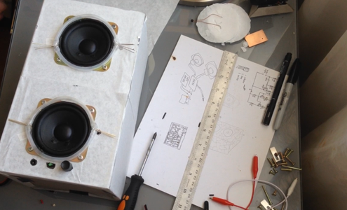

Step 9: Preparing the Circuits
Okay so now we will prepare the CD boxes for holding the speakers and the main amplifier board.
So well, the first thing is to drill the holes for the control of the amplifier (so mine has a potentiometer, which is also the interruptor at the same time, then an LED to show that it's on, and an auxiliar output), so I did the 3 holes for that.
Then I made the holes for holding the speaker in place, so I could put screws to attach them to the CD boxes.
After that, I glued another box to form the first cube. So two CD boxes form a big cube.
Then I needed to make the base of the speakers, It could have been something more solid but I think cardboard as enough to hold it, things aren't that heavy and also we want something which won't conduce electricity so cardboard seems perfect. I glued it at the bottom.
I placed the board on it but it wasn't high enough, so I had the idea to make a little plataform that will hold the board at the right height. It worked perfectly.

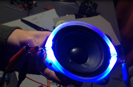

Step 10: Making the Speakers Look Cool
Okay so now I wanted to give the speakers a better look, so I took the phosphorescent bracelets and took off their liquid to get those interesting plastic tubes. It doesn't need to be this, you can use tubes for sipping or anything similar, I just wanted to make them look like some neon tube haha.
So well I first glued the LED's to the extremes of the cubes, I tested it and it didn't look bad so...
Well I used two parts of the tube to light up one speaker (as it can be seen in the pictures), so I used 2 LED's per tube (in each extreme), so 4 LED's per speaker (look at the pics). And I connected them all in parallel, so that' how they will turn on.
The next thing was how would we turn them on, so well, I would use the voltage directly from the power source plus a resistor in serie. That would be enough to turn them on, so I drilled the holes to pass the cables of them. I used 220 ohms resistor, it will depend on how many LED's you put and what kind of LED's, but as I said before just try high value resistors and go lowering their value till you get the brightnes you want (if you don't know anything about resistors).
Step 11: Covering the Body
So here it's where we need the wax paper!
Once we've glued the boxes together to form the body of the speakers, we will cover it all with the wax paper. I have a really big size so it will be enough. I used a stick bar, it worked nice....and here we don't need to care about the bubbles that we might get, because later, it will be covered by the eva foam so don't worry, I didn't stick them well anyway haha.
But well, after that we are gonna make the holes that we did before, it's not hard, so I re made the holes for the speakers and everything but this time on the wax paper.

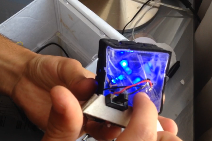

Step 14: Setting Up the LEDs
Anddd another hard part. Yes it's not as easy as it looks.
So, we need to light up the inside with the LEDs and connect them to the LED driver board. As I said before, I used 2 LEDs per transistor.
I connected pairs of LEDs in parallel, and then I had to connect them to the transistors.
The next thing was a real problem that got me thinking for some time: how would I light up all the inside of the speakers with such a little ammount of LEDs? And well, I got the idea to separate it all in 3 "floors", that's how I called it. So the first floor would be at the bottom of the speakers and it would have 4 LEDs, the second floor would be in the middle of all with 4 LEDs more, and the last floor would only have 2 LEDs and they would light up the top of the speakers. And that's what I did.
I made the "floors" with long pieces of cardboard, I folded the extremes of them so they would be perfect to hold the LEDs between the inside walls.
I first connected the first floor and glued it. Then the second one and glued it too. And the last floor would have LEDs in the middle of it to light up the top of the speakers.
Was really hard to connect it all inside the speakers but I DID IT. Hope it won't be that hard for you guys.
