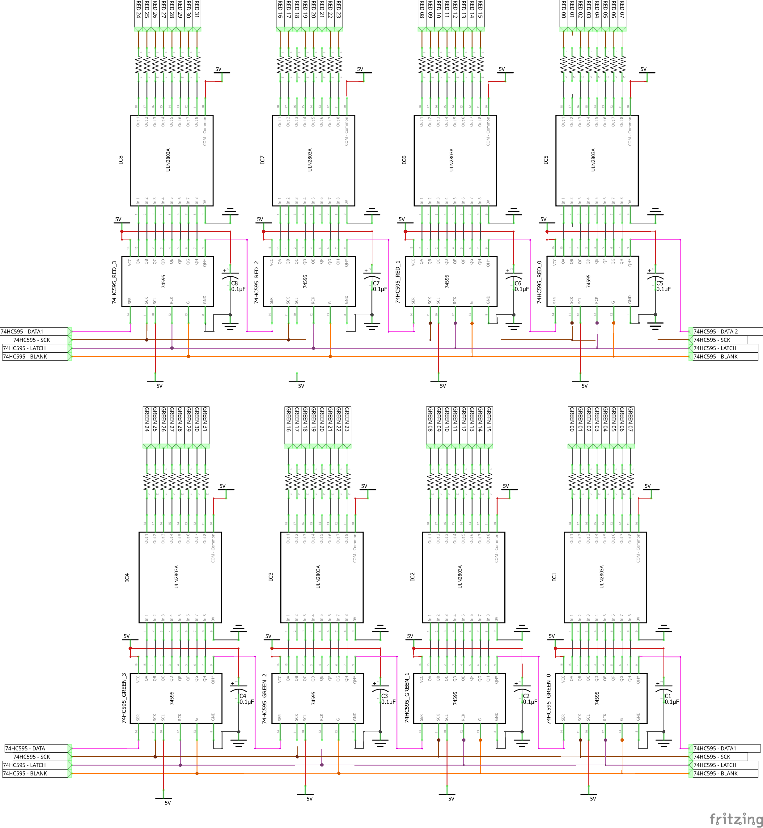

Step 2: SCHEMATIC
Picture above is the circuit diagram of the whole project; you can download a high resolution PDF file HERE.
According to the circuit diagram, there are a total of 5 groups as follows:
  • Bi-color Matrix 16x32 circuit
It consists of 8 x bi-colors led matrix 8x8 and is arranged into 16 rows and 32 columns.
  • Row scanning circuit
It includes the following main components: 8 x 74HC595, 8 x ULN2803, 64 x R100, 8 x decoupling capacitor 0.1uF.

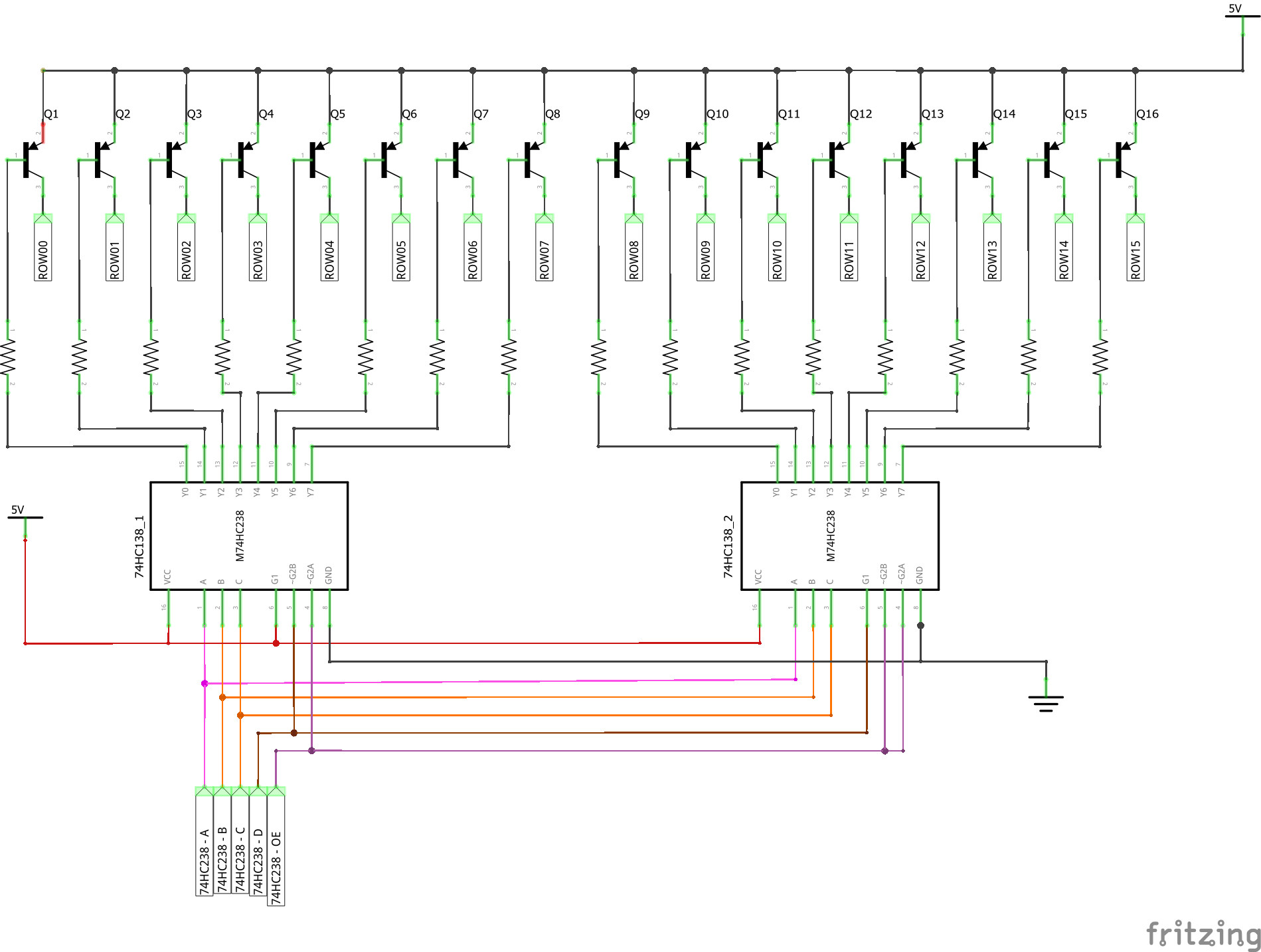

  • Column scanning circuit
It includes the following main components: 8 x 74HC138, 16 x Transistor PNP A1013, 16 x R560.

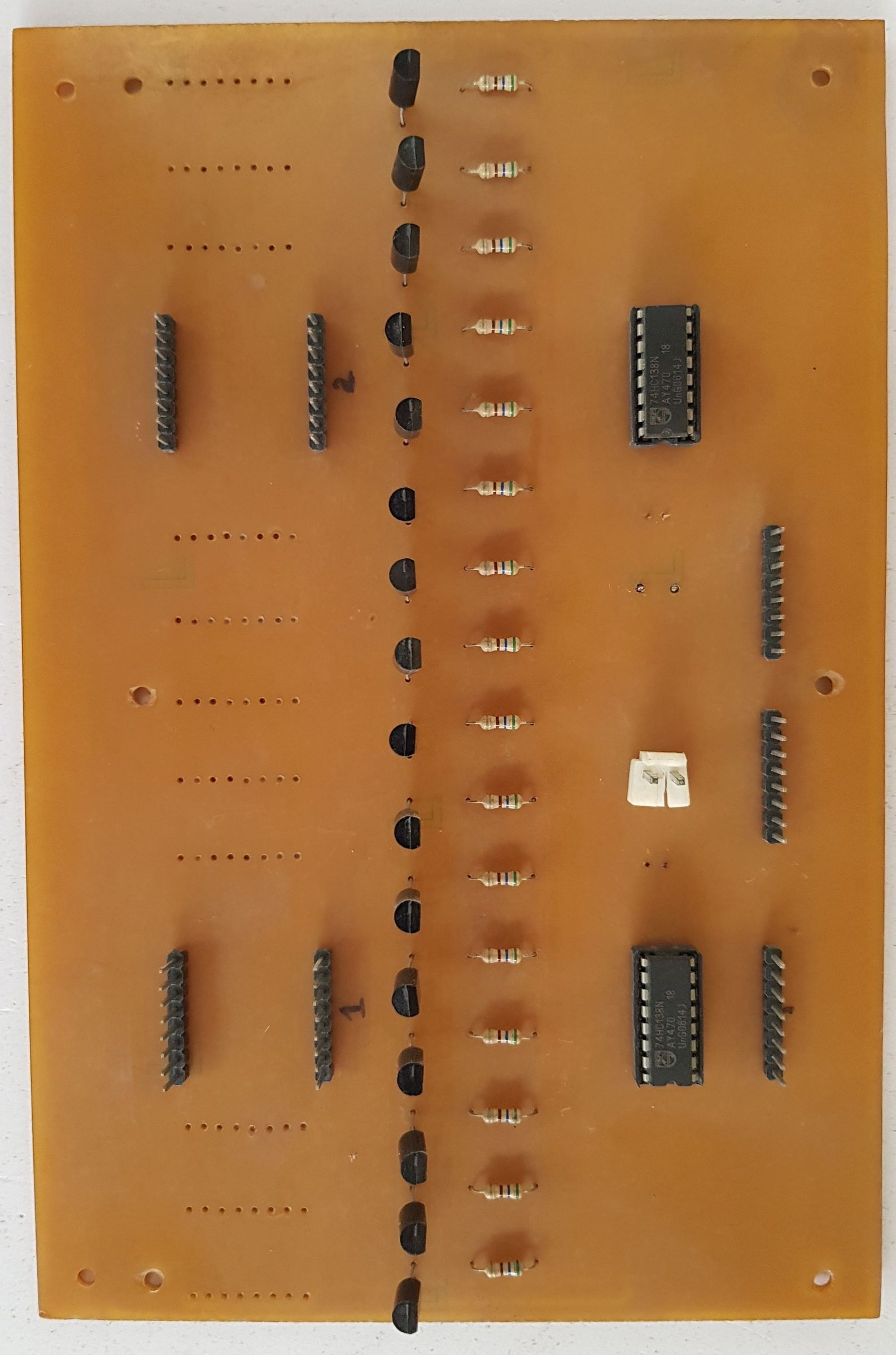

  • Bi-color Matrix 16x32 circuit.
  • Column scanning circuit.
2. For row scanning circuit, in this project I just used 2 x 74HC138 and 16 x PNP Transistor A1013. It's enough to control 16x32 led board.
The complete LED display board is built by 3 PCBs stacked on each other:
  • Bottom layer: row scanning PCB.
  • Second layer: column scanning PCB.
  • Top layer: Bi-color Matrix 16x32.

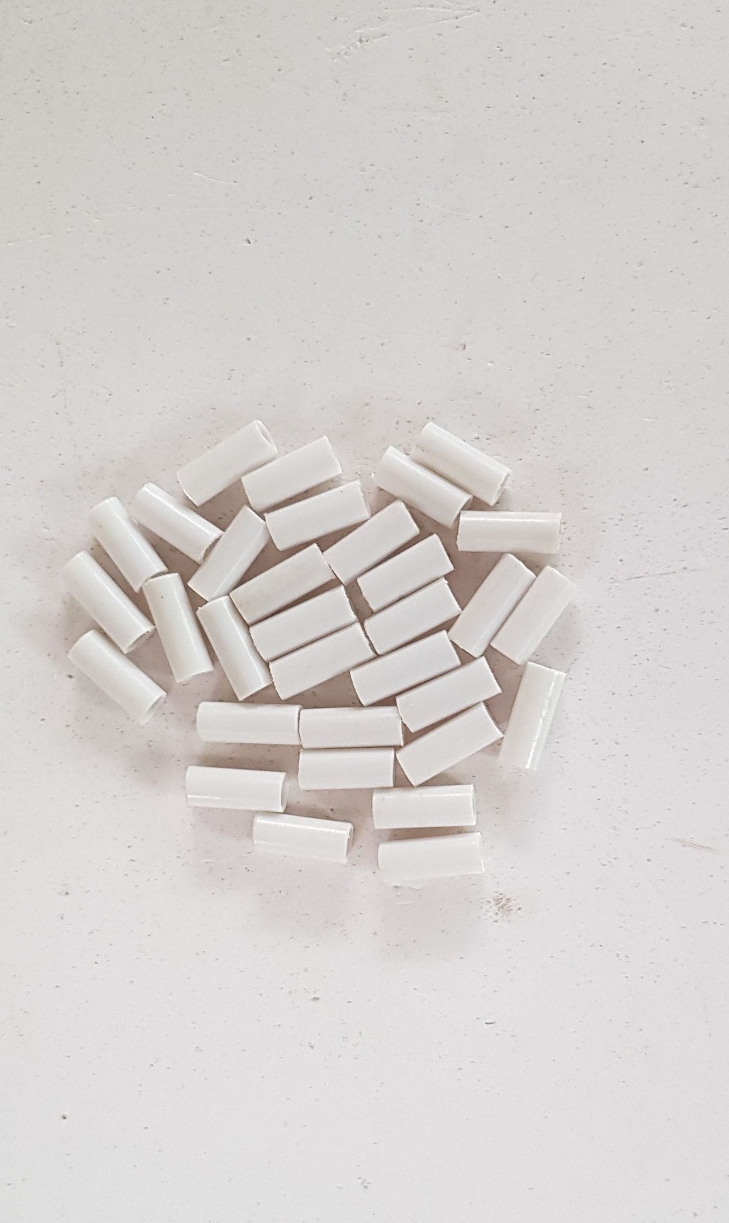

To minimize noises from sunlight or from IR leds placed close together, I have this tip: I cut a white tube with 5mm inner diameter, each piece about 1.5cm length to cover all IR leds and photo-transistors.
It looks like that after covering by tube:

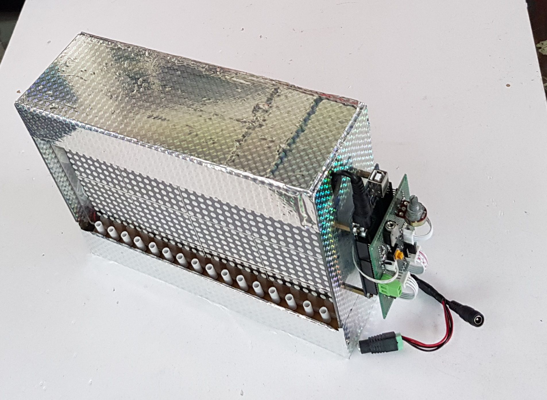

Making a acrylic frame to mount IR LED and photo-transistors circuits on it, paying attention to the alignment so that they are in symmetrical opposite. This acrylic frame will also contain the led matrix board inside, so when we drilled holes to mount all circuits it should be relatively accurate.
4. Arduino Mega Shield circuit
Arduino Mega pins usage is following the below table.
I soldered Arduino Mega shield with some male headers on double sided printed prototyping board 7x9cm.
Making another outer acrylic frame to contain all the circuits inside and mounting Arduino Mega shield outside this frame.
Here's results after soldering and mounting Arduino Mega shield on the outer acrylic frame.
5. Finish
Rearranged and stick decorative sheet for interactive led panel. Done!

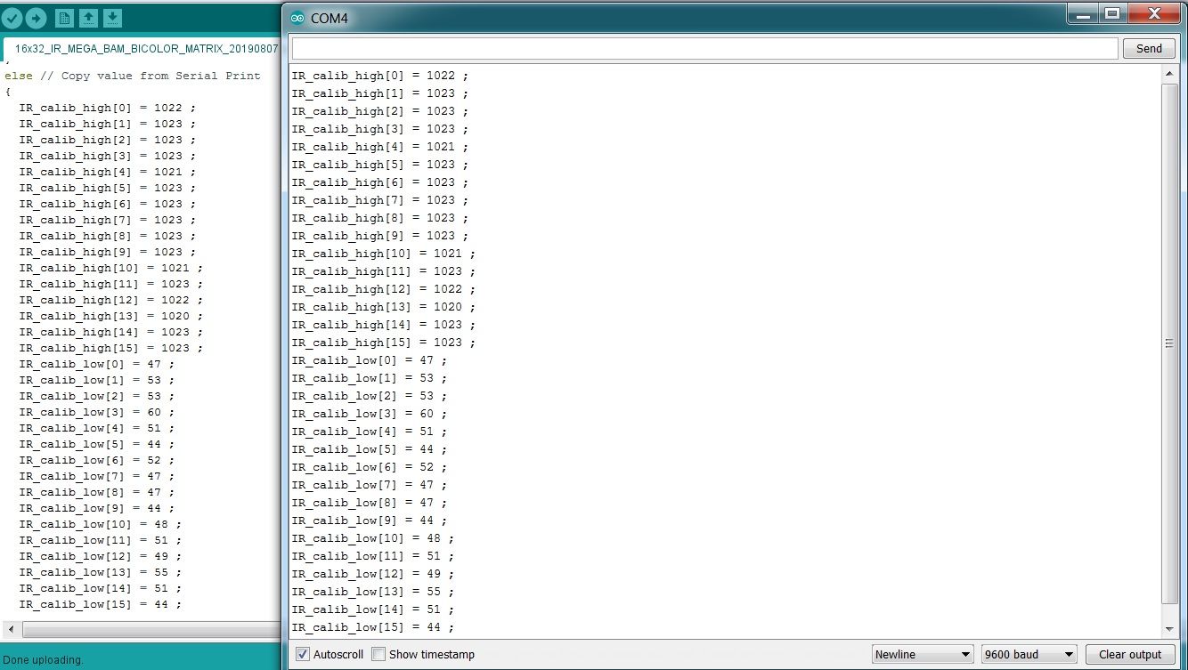

For touch action working correctly, firstly we have to calibrate the led board in 2 modes:
  • High - Calibration: Leave the led panel freely in 5 seconds so that the photo-transistor can read IR leds in no-touch mode. All data of high calibration will be stored in array "IR_calib_high".
  • Low - Calibration: Cover all photo-transistors in 5 seconds, this time is simulated as if a touch operation is in taking place. All data of low calibration will be stored in array "IR_calib_low".
The instruction message will be shown on matrix panel during calibration process.

During calibration process carrying out, we open Serial Port in Arduino IDE then copy all printed data into the program. The purpose of this work is that we no need to re-calibrate in the future when the led board has been placed in a fixed location. The printed values shown on Serial Port is as picture below:
In addition, we need to pay attention to the operation of led board at daytime or nighttime. We can see the difference when calibration process is done on the daytime or nighttime through the following table:

Above are some pictures taken during my implementation of this project.
