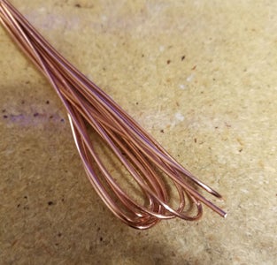

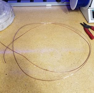

2. 28 AWG enameled wire. You could go thicker or thinner if you wanted. Thicker would be a bit easier to work with but would take up a lot of space near the base of the tree. You can also go thinner but the wire starts to get fragile when you're working with it.

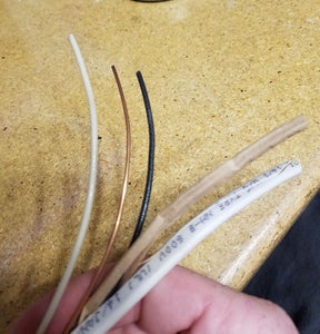

3. Your primary wire simply needs to be sturdy. I used some 14 gauge wire from a 14-2 spool of "building wire", used for home electrical work, that I had laying around. A 10' section works great and yield 3 - 10' pieces of wire after you remove the insulation.

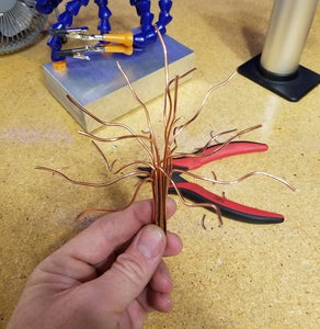

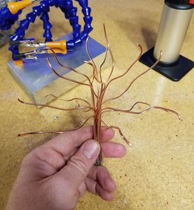

To build the trunk, grab one section of bare wire.
1. Fold it multiple times until it is 6 - 10" inches long.
2. Stick the bundle of wire in some vice grips and solder one side of it. It will make a nice bundle of wire for the trunk.
3. On the side you didn't solder, cut the wire at the bends.

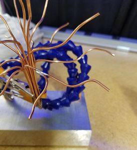

4. Randomly bend down each wire to create a tree. Do it the same way you would setting up a fake Christmas tree.
5. Take each limb and bend it, put kinks in it, make it random. Feel free to twist up and knot the trunk of the tree. The more you do this, the better it looks.
6. Cut the limbs so that the wire tapers up towards the top and resembles more of a tree's shape.
7. Adding additional limbs will bring a lot of density to the tree's canopy. To do this, cut 5" sections of wire and solder them to the limbs you created earlier.
8. Add as many pieces as you like. The tree I built has 29 limbs on it.

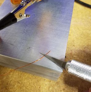

1. The enamel coating can be a bit of a pain to get off of the wire. I used a razor blade to scrape off the coating. I've seen other people use sand paper. If you have a good idea, toss it into the comments below.
2. After you've removed about 4mm of the coating from the wire, tin it with solder.

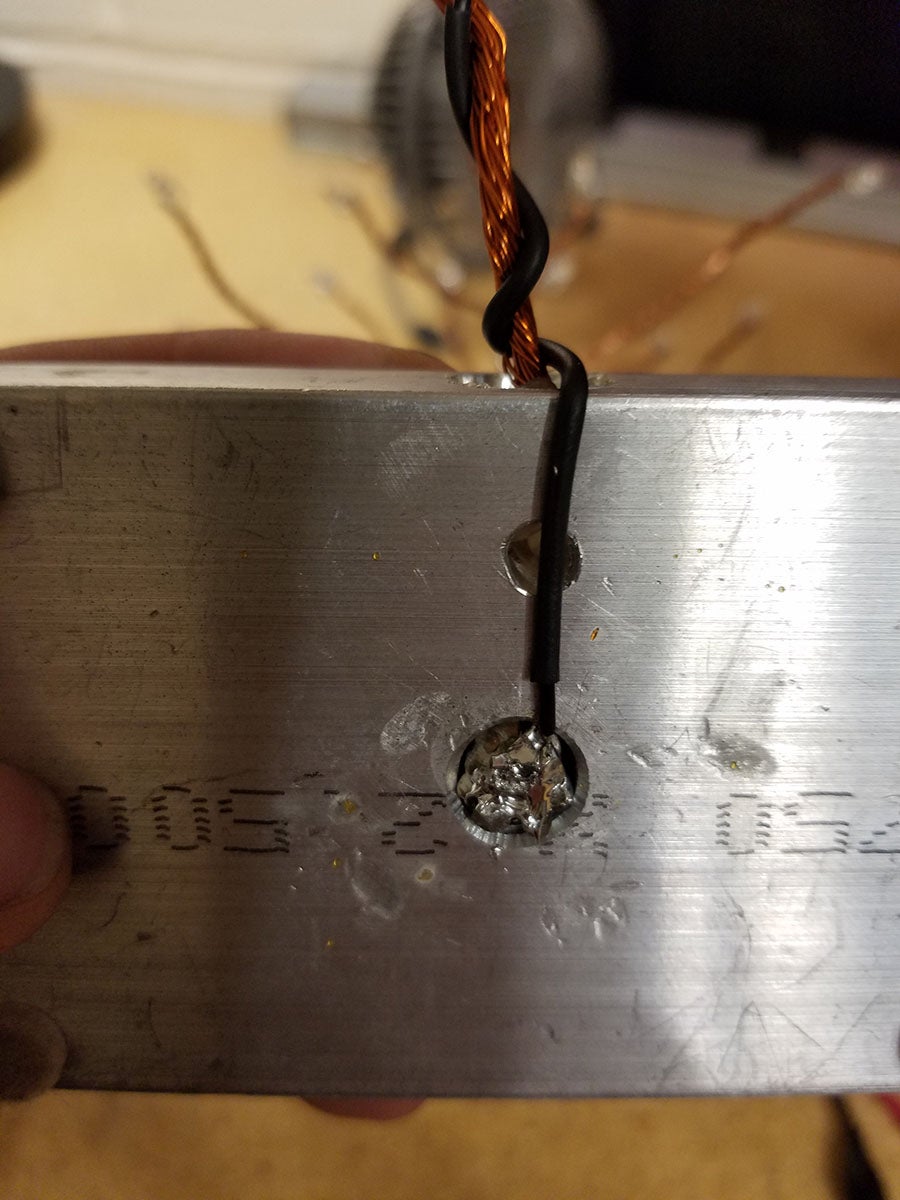

1. Drill a decent size hole into a block of aluminum that will serve as a base.
2. Stick the tree trunk into the hole.
3. From the opposite side, I pounded in a couple small nails to make for a tight fit and to secure the trunk to the base.
4. A couple felt feet were added to the base to make way for the ground wire and to keep the aluminum from scratching things.

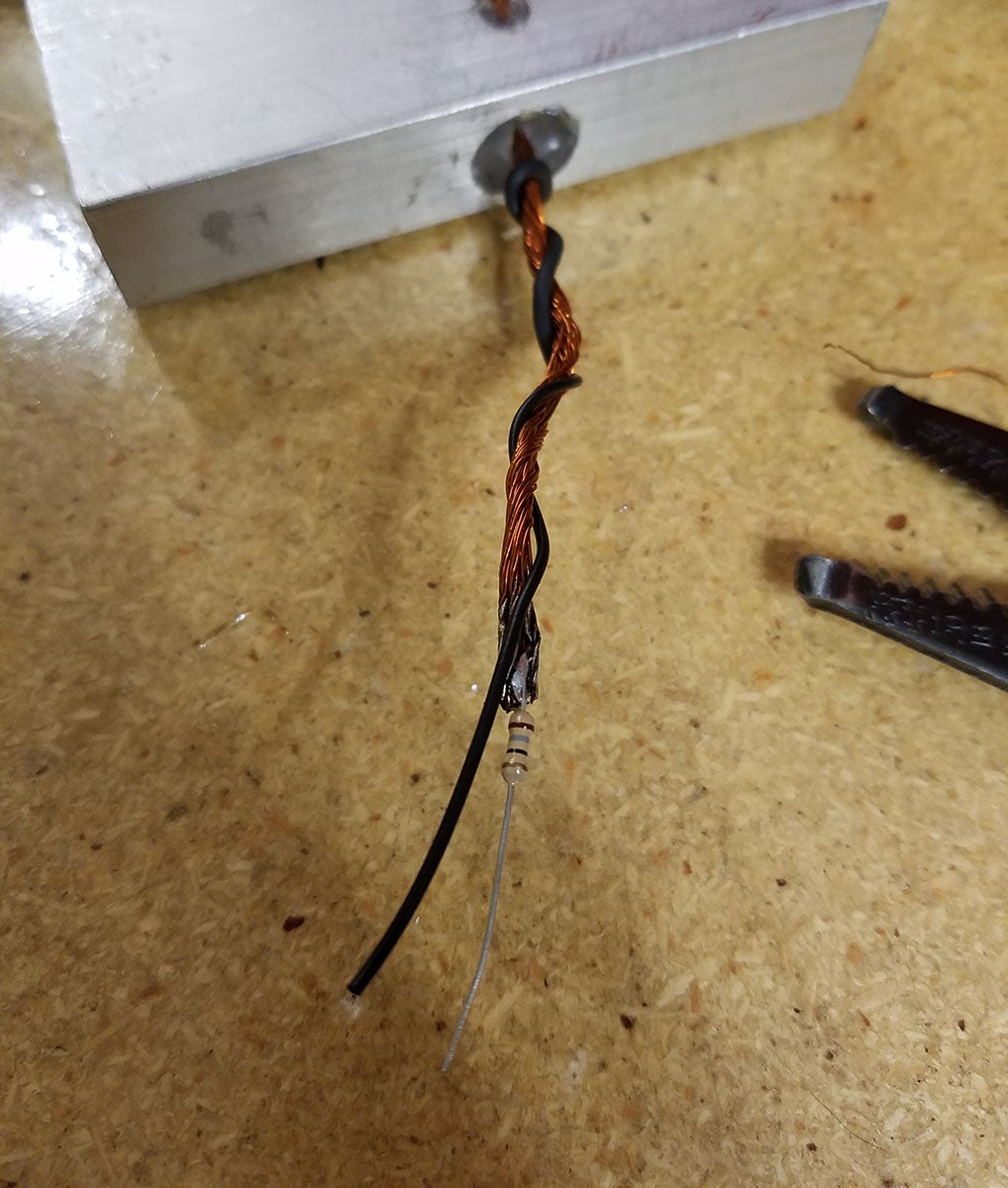

5. Solder the ground wire to the trunk or anywhere on your metal base.
6. All of the enameled wires should be gathered at the base and cut to the same length.
7. Scrape off the enamel coating and solder the bunch together.
Since I was using a 5v USB power supply to run the tree, I had to do a bit of math to find a decent resistor for the LEDs. The LEDs I used were designed to run at 3 volts with a 20 mA forward current. This makes them very bright. I used an online LED calculator to find the required resistor using 3 volts and a 5 mA forward current for the LED. The ideal resistor is 470 ohms, one for each LED. Each LED should technically have it's own resistor but I didn't think it would look as good so I figured out what resistor would be required to run the whole parallel array.
The math worked out as 1/((1/470)*29) = 16.4 ohms. I preferred these LEDs to be a bit dimmer so I settled for an 18 ohm resistor.
The math simplified 1 / ( (1/ OhmsPerLED) * TotalNumberOfLeds) = Ohm value of required resistor.
Solder that resistor on the end of your bundle of enameled wire.

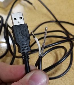

Cut the end off of a USB cable and solder the center wire (or whatever ever wire you have that is positive) to the other end of the resistor.
Solder the shielding (or negative) wire to the wire that ground the tree trunk.
You can now power up the Tree!!

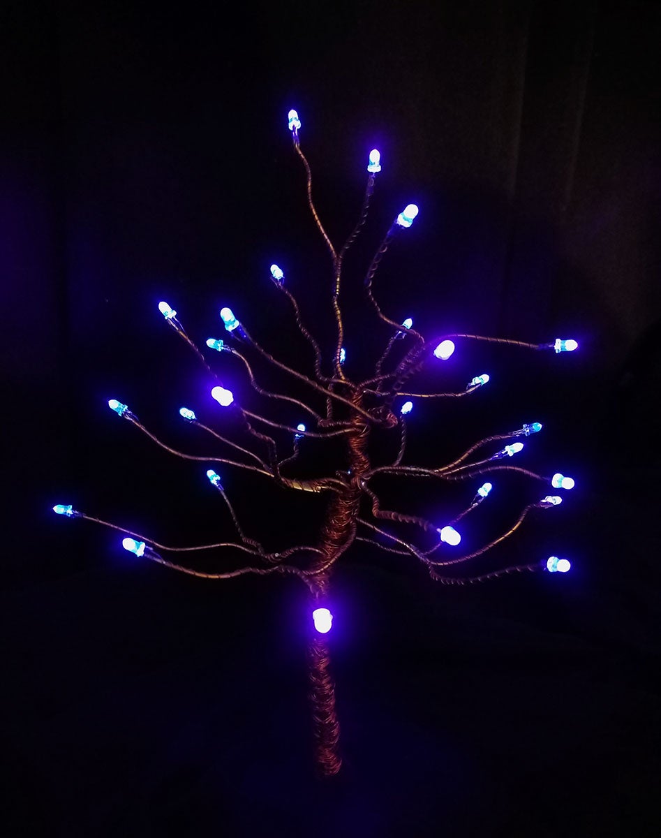

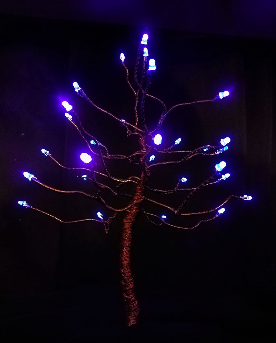

Now that your tree is lit up you can spend a moment to adjust the limbs and LEDs to get better lighting.
You may find yourself adjusting the resistor value a bit to make the tree brighter or dimmer.
Enjoy and share your builds here!!
