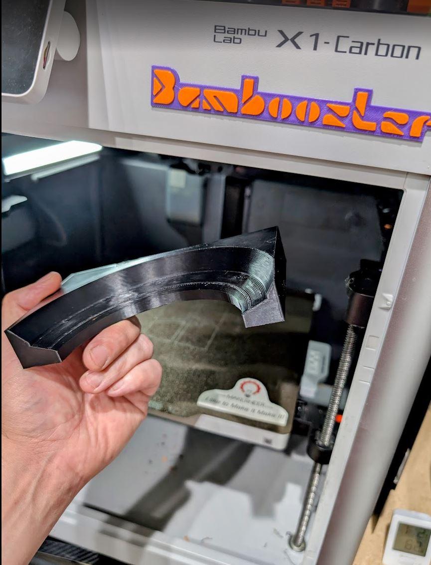

Save the file. Now lets 3D print a small slice to see how close we actually are to the profile. Looks like we're close enough for what we need: height is correct, width is correct, flange/tire bead profile is very close, the inside sweep to the hub is off though (which sorta makes sense, this would be the furthest from the camera lense and possibly the most distorted area?).
The TPU print is probably going to take forever, so I should probably get going on the tire and come back to refine the rim hub more later.

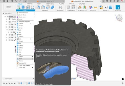

Next, there's no more putting off mating the utility tire rim profile to the brick tire profile. So, right click on the rim model and insert it into the tire model. Since we're modding the tire, not the rim (yet...) its easier to do it in the tire model instead of the rim model. Now a joint needs to be added to put the rim into the center, center of the tire (as opposed to centered concentrically but on the top or bottom face of the tire). Go to the assemble menu and select joint (or Ctrl+J). (You may be prompted to "unground" the model from the parent, right click on the rim and select unground). Make sure a rigid joint is highlighted and select the center of the bottom face of the rim. Then select the center, center of the tire, it may help to turn on the origin and select that.
With the rim inserted into the tire model, it's obvious the chamfer I created earlier in the tire model is not helpful. To remove it right click on it in the timeline and suppress it.
At this point it's going to be helpful to have a section/cut out view. Select this from the inspect menu and then select the front plane.
OK, another sketch on the front plane (aren't we glad everything is center centered now!), project the top and bottom of the tire and the inside profile of the rim into the sketch (Ctrl+p). Then create a closed sketch up to about where the wheel flange ends. And now revolve join the sketch to the tire body (might help to eyeball off the rim in the design tree). Sooooo close, in the create menu select mirror, set it to features and select the last revolve feature and select top plane as the mirror plane.

How about we compromise and print a proof of concept in something faster?!
Good plan.

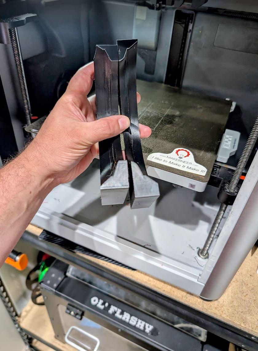

While we're thinking about it... since I'm not 100% confidant in the hub profile, lets also print just a portion of the wheel to triple check things. This is really easy to do in the slicer with the cut command. And will only take about 30ish minutes to print for the test.
Whooops... it hits the rim. Good thing we tested. Back to Fusion to fix it. I see two ways to fix this. 1, change how far the hub extrude extends down the profile of the wheel, or 2, add a fillet to that edge. I'm going for #2, so drag the timeline slider on the bottom of the screen back to the hub revolve feature. Add a fillet, my eyecrometer says 10mm is too much and 5 isn't enough so I went with an 8mm fillet. Update the mirror feature to include the revolve and the new fillet, slide the timeline back to the end and bam, done! Easy peasy.

One more small profile test print (being able to test and iterate quickly with 3D printing is awesome!) looks good! OK, lets print a whole proof of concept tire in high flow PETG!!!!!!!!!!!!!!!!!
One sleep later and it's now real! It's undeniably brick-like, it fits great and I love it!

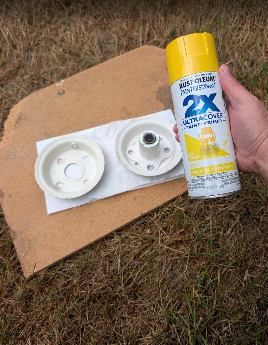

Paint it yellow!
I gave hub halves a quick clean and hit it with a couple coats of yellow spray paint. Yes! I love it when a plan comes together!
Just need to wait for the paint to dry and the 3D printed tire to finish now...

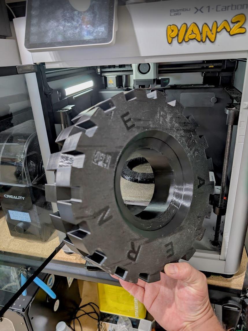

Aaaannnnndddddd... They're done! Assemble!
Note: Removing supports from TPU can be a PITA. Do the best you can, sometimes a little heat helps too. Fortunately this area will be covered by the wheel hub.

Now, the only thing left to do is put it on the log splitter!
YESSSSSSS!
It's glorious, I don't quite know how to explain how happy this makes my maker brain!
But I know what you're going to ask next: How tire-y is the tire?! Surprisingly tire-y, which turns out to be really hard to quantify so checkout the video attached!
